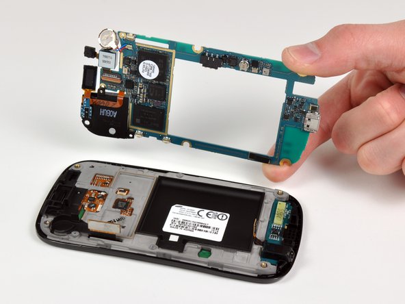

    4. Nexus S Front Panel Assembly Replacement: step 14, image 1 of 2 Nexus S Front Panel Assembly Replacement: step 14, image 2 of 2
      • Wedge the plastic opening tool near the bottom right corner of the motherboard and pry upwards to dislodge it from its recess.
      • Lift and remove the motherboard.
      Ask FixBot
    1. Nexus S Front Panel Assembly Replacement, Front Panel Assembly: step 15, image 1 of 1
      • Front panel assembly remains.
      Ask FixBot
