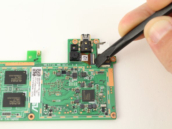

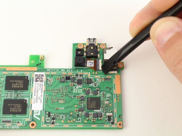

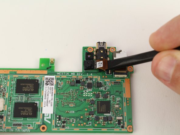

    1. Nexus 7 2nd Generation Front Facing Camera Replacement, Front Facing Camera: step 22, image 1 of 3 Nexus 7 2nd Generation Front Facing Camera Replacement, Front Facing Camera: step 22, image 2 of 3 Nexus 7 2nd Generation Front Facing Camera Replacement, Front Facing Camera: step 22, image 3 of 3
      • Flip the motherboard over to reveal the ZIF connectors for the two cameras.
      • The front facing camera will be the one on the left side. Start by prying the locking bar of the ZIF connector up with a spudger.
      Ask FixBot
    2. Nexus 7 2nd Generation Front Facing Camera Replacement: step 23, image 1 of 2 Nexus 7 2nd Generation Front Facing Camera Replacement: step 23, image 2 of 2
      • Place the pointy end of the spudger underneath the cable ribbon to pull it from the connector.
      • Pry the camera off of the motherboard from the cable side and remove it from the motherboard.
      • You will likely damage the ribbon cable of the old camera when prying due to the strong adhesive used, but as long as you've got a replacement it shouldn't be a problem. You also may want to put a small drop of adhesive beneath the camera to affix it to the motherboard after installing it.
