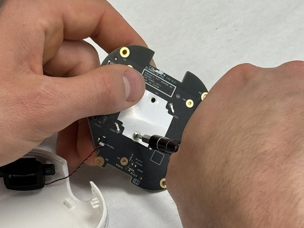

    2. Nanit Pro N301 Camera Replacement: step 2, image 1 of 1
      • Remove the four 4 mm T6 Torx screws from each corner of the circuit board.
      • Lift the circuit board out of the chassis.

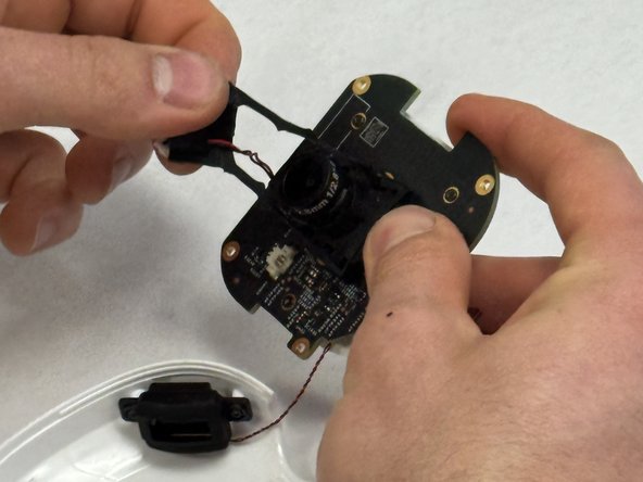

    4. Nanit Pro N301 Camera Replacement: step 4, image 1 of 1
      • Disconnect the white camera connector from the circuit board.
      • Do not pull on the wires.

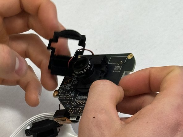

    6. Nanit Pro N301 Camera Replacement: step 6, image 1 of 2 Nanit Pro N301 Camera Replacement: step 6, image 2 of 2
      • Remove the filter from behind the camera lens.

    7. Nanit Pro N301 Camera Replacement: step 7, image 1 of 2 Nanit Pro N301 Camera Replacement: step 7, image 2 of 2
      • Use a T4 Torx screwdriver to remove the screws that secure the computer chip to the white plastic bracket.
      Ask FixBot

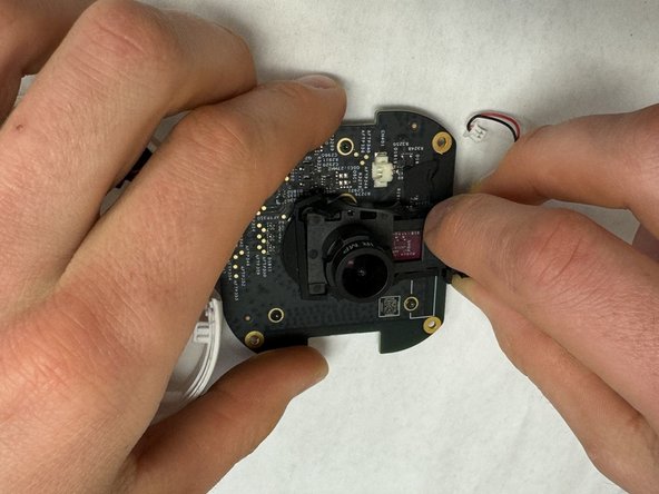

    8. Nanit Pro N301 Camera Replacement: step 8, image 1 of 1
      • Gently pull the circuit board away from the white plastic bracket.

    9. Nanit Pro N301 Camera Replacement: step 9, image 1 of 2 Nanit Pro N301 Camera Replacement: step 9, image 2 of 2
      • Use a Phillips screwdriver to remove the two screws that secure the underside of the camera.

    10. Nanit Pro N301 Camera Replacement: step 10, image 1 of 1
      • Gently lift the camera up and off the circuit board.
