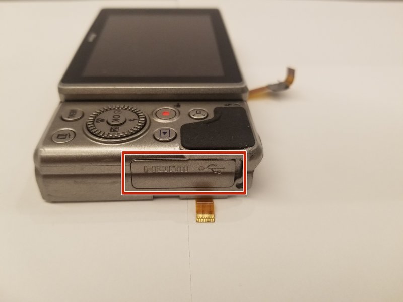

  10. NIkon Coolpix A900 I/O Cover Replacement, I/O Cover: step 10, image 1 of 3 NIkon Coolpix A900 I/O Cover Replacement, I/O Cover: step 10, image 2 of 3 NIkon Coolpix A900 I/O Cover Replacement, I/O Cover: step 10, image 3 of 3
    • Locate the I/O cover on the rear case.
    • On the inside of the case, unhook the I/O cover by lifting up.
    • You may not need the spudger to remove the cover.
  11. NIkon Coolpix A900 I/O Cover Replacement: step 11, image 1 of 1
    • Remove the I/O cover by gently pulling away from the rear case.
