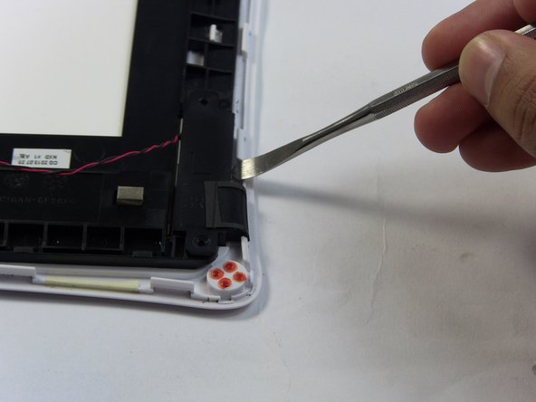

    1. NABI XD Screen Replacement, Speakers: step 12, image 1 of 3 NABI XD Screen Replacement, Speakers: step 12, image 2 of 3 NABI XD Screen Replacement, Speakers: step 12, image 3 of 3
      • Right (R) speaker removal:
      • Remove one 4mm Phillips screw.
      • Use the metal spudger to separate the speaker from the frame.
      • The speaker is glued to the Nabi XD it will require some force to separate them.

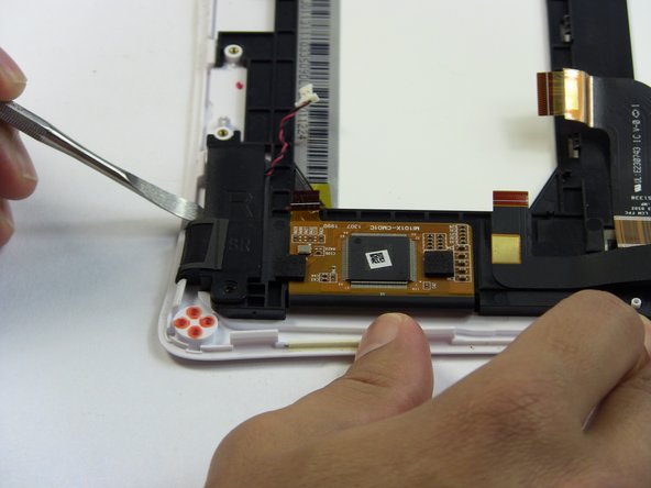

    3. NABI XD Screen Replacement: step 14, image 1 of 3 NABI XD Screen Replacement: step 14, image 2 of 3 NABI XD Screen Replacement: step 14, image 3 of 3
      • Left (L) speaker removal:
      • Remove two 4mm Phillips screws.
      Ask FixBot

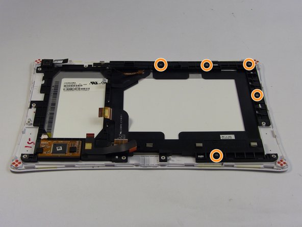

    1. NABI XD Screen Replacement, Screen: step 15, image 1 of 3 NABI XD Screen Replacement, Screen: step 15, image 2 of 3 NABI XD Screen Replacement, Screen: step 15, image 3 of 3
      • The ribbons are glued to the frame so gently lift them up without ripping them.
      • Lightly lift the marked wires and ribbons from the frame by gently pulling them in the direction of the arrows and up.
      • Remove five 4mm Phillips screws from the frame.
      Ask FixBot

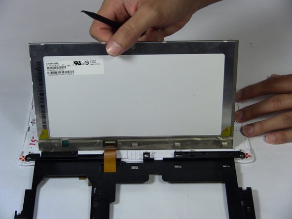

    2. NABI XD Screen Replacement: step 16, image 1 of 2 NABI XD Screen Replacement: step 16, image 2 of 2
      • Use the Plastic Opening tools to lift the frame up.
      • The ribbons need to be detangled from the frame while you are lifting it up.
      • Do not yank the frame away from the Nabi XD it is connect to it by a ribbon. Gently lift.
      Ask FixBot
    3. NABI XD Screen Replacement: step 17, image 1 of 2 NABI XD Screen Replacement: step 17, image 2 of 2
      • Lift the screen up with the black spudger.
      • Lift the frame up slowly and place it to the side.
