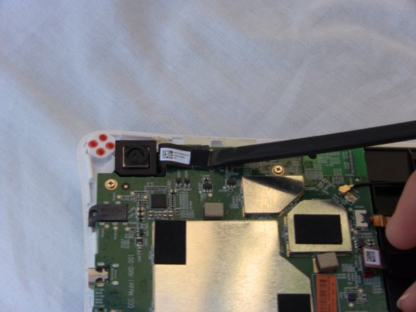

    • To remove the marked ribbons, use your fingernails or a spudger to lift up small tab
    • Use the Precision Tweezers to gently pull the ribbons straight out of the connectors.
    • You need to remove 4 ribbons
  8. NABI XD Motherboard Replacement: step 8, image 1 of 3 NABI XD Motherboard Replacement: step 8, image 2 of 3 NABI XD Motherboard Replacement: step 8, image 3 of 3
    • Disconnect the camera by lifting the ribbon straight up. Also disconnect the remaining ribbon by lifting up gently.
    • To disconnect antenna wire, use the tweezers to pry connector straight from the board.
  9. NABI XD Motherboard Replacement: step 9, image 1 of 2 NABI XD Motherboard Replacement: step 9, image 2 of 2
    • Disconnect the Right speaker by grabbing the wire head by its sides and pulling it back from the connector.
  10. NABI XD Motherboard Replacement: step 10, image 1 of 2 NABI XD Motherboard Replacement: step 10, image 2 of 2
    • Remove the four 4mm Phillips screws with the PH#0 screwdriver.
  11. NABI XD Motherboard Replacement: step 11, image 1 of 1
    • Lift the motherboard up away from the Nabi XD.
