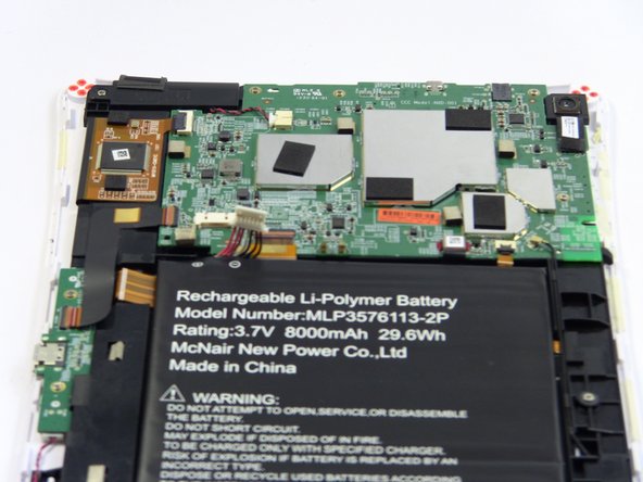

    1. NABI XD Battery Replacement, Battery: step 3, image 1 of 2 NABI XD Battery Replacement, Battery: step 3, image 2 of 2
      • Place your fingernails on both sides of the connector and pull it straight back away from the holder.
      Ask FixBot
    2. NABI XD Battery Replacement: step 4, image 1 of 1
      • Battery is glued to the base, lift carefully.
      • To remove battery, lift the battery up from the motherboard.
