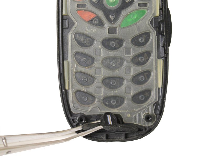

    1. Motorola i710 Microphone Replacement, Microphone: step 4, image 1 of 3 Motorola i710 Microphone Replacement, Microphone: step 4, image 2 of 3 Motorola i710 Microphone Replacement, Microphone: step 4, image 3 of 3
      Tool used on this step:
      Buy
      • Lift the circuit board away from the case of the phone, being careful not to break the wire that goes up into the hinge. This will give you access to the microphone.
      • The microphone sits just below the keys on the front cover molding.
      • Grasp the microphone with tweezers and lift it out of the front cover.
