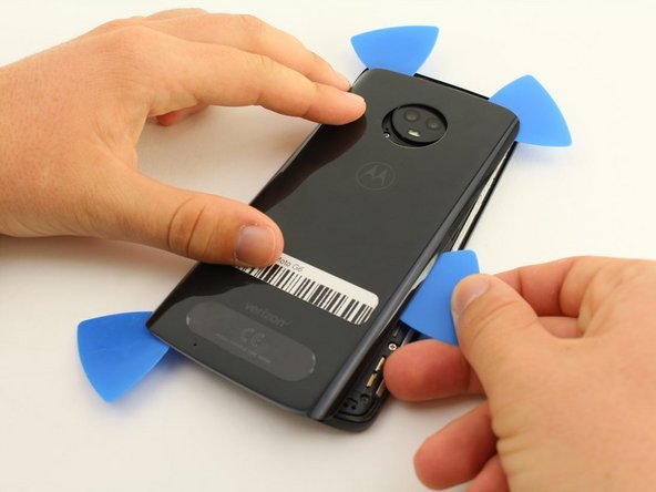

    2. Motorola Moto G6 Back Shell Replacement: step 2, image 1 of 1
      • Insert iFixit opening picks under each corner of the back shell.
      • You may need to hold the corners open with the iFixit opening tool to be able to slide the picks under the shell.

    3. Motorola Moto G6 Back Shell Replacement: step 3, image 1 of 2 Motorola Moto G6 Back Shell Replacement: step 3, image 2 of 2
      • Slide the picks along the edges of the device until the adhesive loosens and allows the cover to come off.
      • There is adhesive all the way around the camera lens.
      • Gently remove the back cover.
