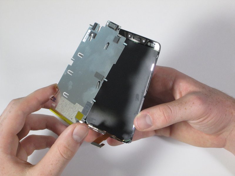

    1. Motorola Droid RAZR M Display Replacement, Display: step 9, image 1 of 1
      • Holding the front assembly, carefully peel back the flat orange wire that is attached to the display from the silver backing. The silver backing is the plating where the speaker is located.'''

    2. Motorola Droid RAZR M Display Replacement: step 10, image 1 of 1
      • Remove the speaker from the display by unhooking it from the two small metal spines on either side of the speaker marked by two the red squares.
      • In addition to the two metal spines, there is adhesive underneath the top of the silver plating of the speaker attaching it to the display.
      Ask FixBot
    3. Motorola Droid RAZR M Display Replacement: step 11, image 1 of 1
      • Carefully lift the silver plating out of the metal spines, separating it from the display.
      • You will then be left with display with the orange wire attached.
