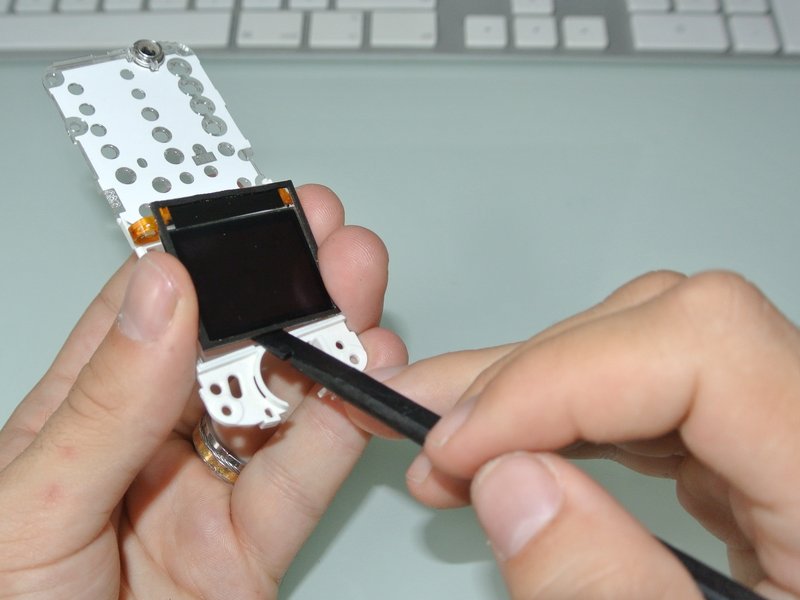

    3. Motorola C350 Display Replacement: step 9, image 1 of 1
      • Use a plastic spudger to release the disconnected screen.
