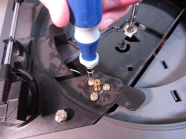

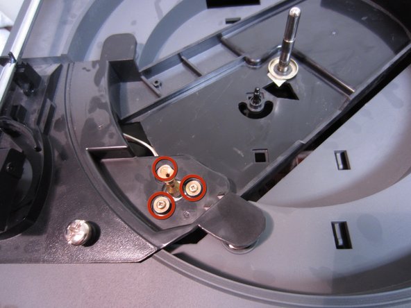

    • Remove the three brass screws using a phillips #1 screwdriver.

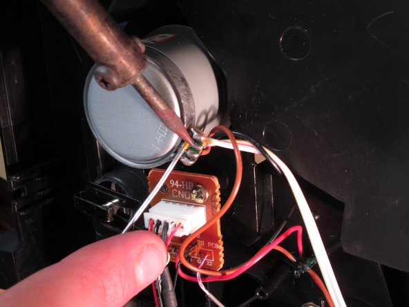

    • Cut the wires that are attached to the motor.
    • Be sure to note the attachment point so that the wires can be reattached to the new motor.

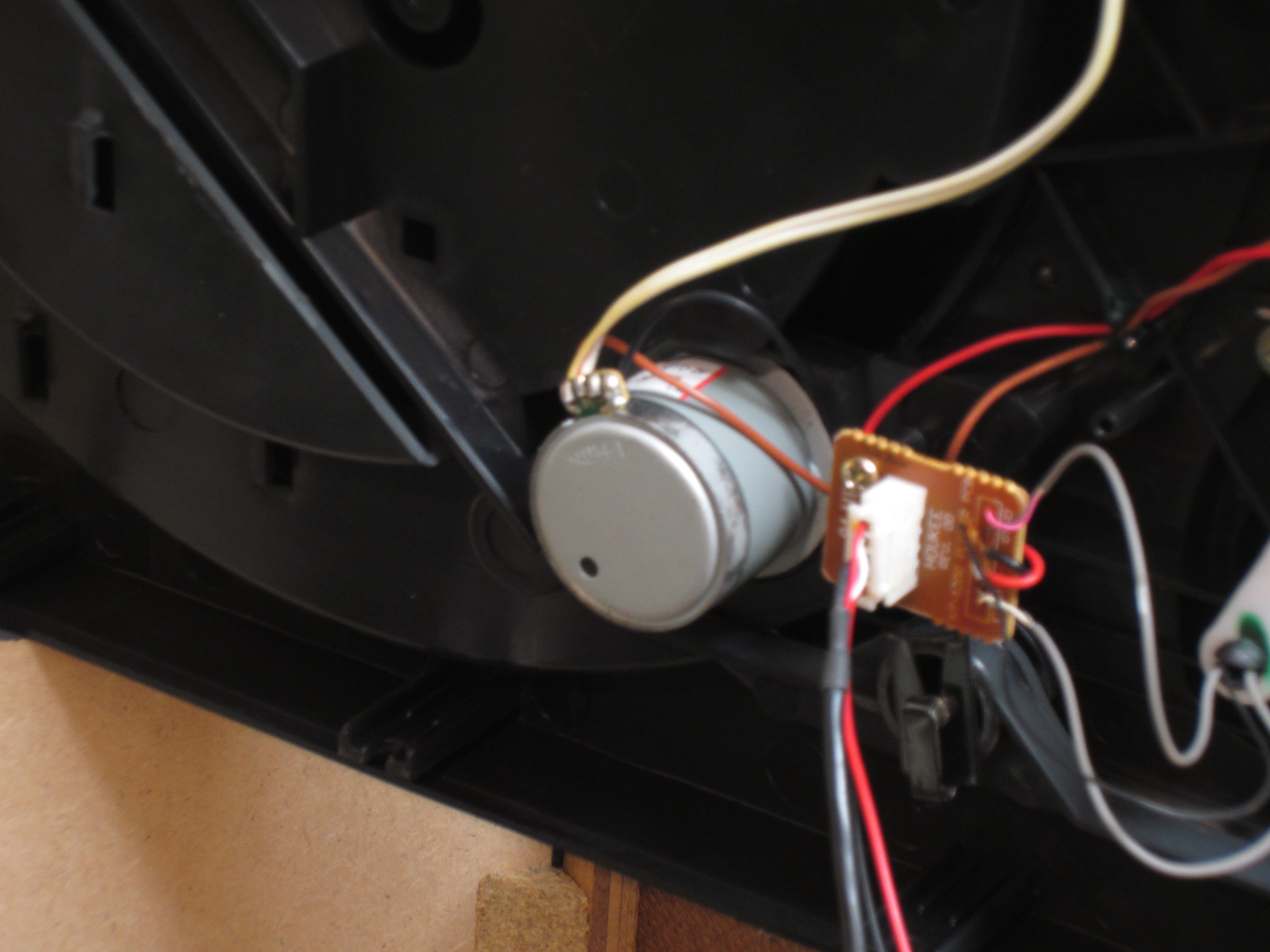

    • Using the phillips #1 screwdriver, remove the three screws that are holding the circular mounting bracket to the motor.
    • Remove the circular mounting bracket from the motor.
  4. Teac DC-D2831 Motor Replacement: step 4, image 1 of 2 Teac DC-D2831 Motor Replacement: step 4, image 2 of 2
    • Attach the mounting bracket to the new motor.
    • Insert the new motor.
    • Flip the turntable over making sure the motor stays in place, and insert the screws underneath the turntable.

    • The ends of the wires will need to be stripped before soldering.
    • Be extremely careful not to burn yourself while soldering.
    • Solder the wires cut wires onto the motor in the location recorded previously.
