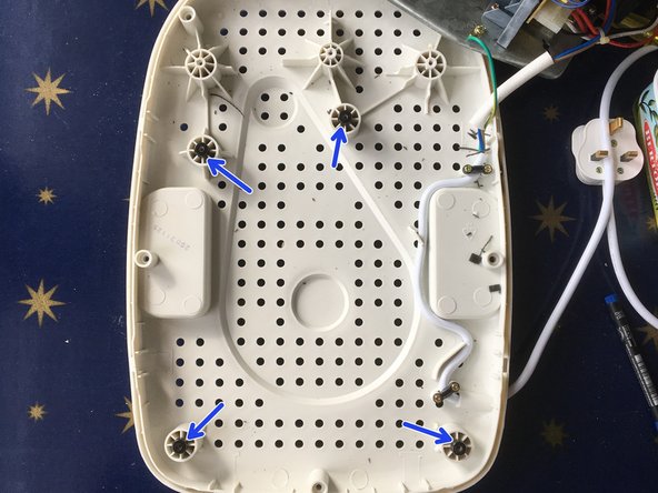

  4. Morphy Richards Fastbake breadmaker 48280 belt replacement: step 4, image 1 of 2 Morphy Richards Fastbake breadmaker 48280 belt replacement: step 4, image 2 of 2
    • Undo 7 screws holding the metal plate to the plastic base cover (mark their positions to aid reassembly as there are 15 holes in the metal plate)
    • Gently, partially lift off the metal plate, noting that they are still electrically connected by mains wire as in the second image.
    • Note in the second image there are four loose black spacers on the attachment posts (blue arrows) and three posts without spacers. Marks positions to aid reassembly.
    • You can remove the mains wiring if desired or just turn over the metal plate to expose the drive belt.
