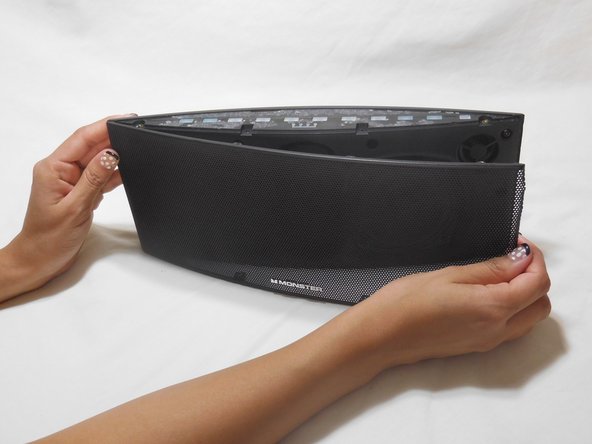

    3. Monster SoundStage S1 Mini Disassembly: step 3, image 1 of 2 Monster SoundStage S1 Mini Disassembly: step 3, image 2 of 2
      • Remove the metal screen.
      Ask FixBot

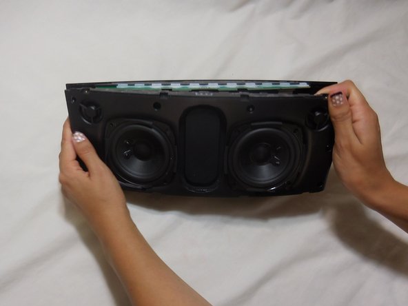

    6. Monster SoundStage S1 Mini Disassembly: step 6, image 1 of 3 Monster SoundStage S1 Mini Disassembly: step 6, image 2 of 3 Monster SoundStage S1 Mini Disassembly: step 6, image 3 of 3
      • Lift the speaker assembly and remove the stuffing.
      • When returning the speaker assembly, make sure the stuffing is tucked in.
