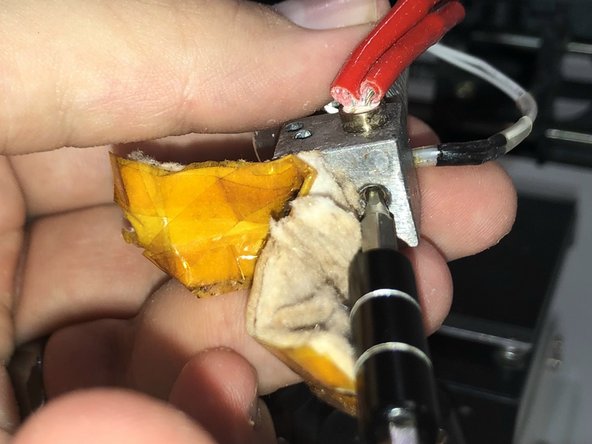

  4. Monoprice Select Mini V2 3D Printer Heating Element and Temperature Sensor Replacement: step 4, image 1 of 3 Monoprice Select Mini V2 3D Printer Heating Element and Temperature Sensor Replacement: step 4, image 2 of 3 Monoprice Select Mini V2 3D Printer Heating Element and Temperature Sensor Replacement: step 4, image 3 of 3
    • Pull back the insulation until you have access to the grub screw at the bottom of the heater block.
    • Use the hex driver to loosen the grub screw.
    • Remove the heating element from the heater block.

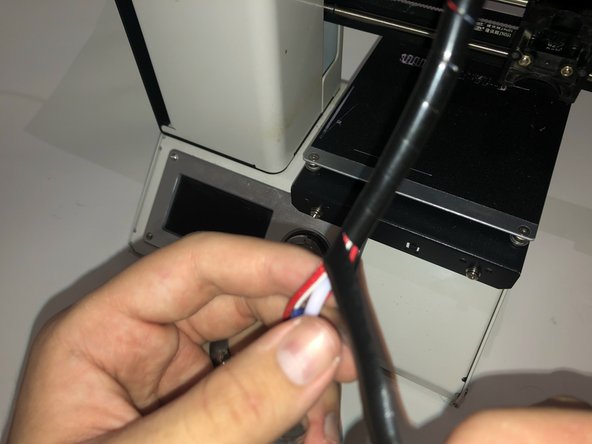

    • Unwind the spiral wrap from the wires leading from the hotend to the printer body.

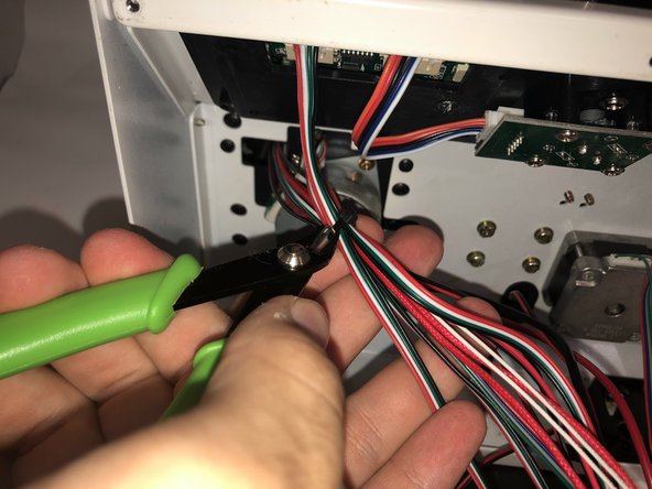

  8. Monoprice Select Mini V2 3D Printer Heating Element and Temperature Sensor Replacement: step 8, image 1 of 3 Monoprice Select Mini V2 3D Printer Heating Element and Temperature Sensor Replacement: step 8, image 2 of 3 Monoprice Select Mini V2 3D Printer Heating Element and Temperature Sensor Replacement: step 8, image 3 of 3
    • Clip the zip ties holding the wire bundle together.

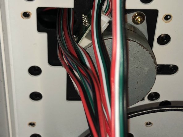

  12. Monoprice Select Mini V2 3D Printer Heating Element and Temperature Sensor Replacement: step 12, image 1 of 3 Monoprice Select Mini V2 3D Printer Heating Element and Temperature Sensor Replacement: step 12, image 2 of 3 Monoprice Select Mini V2 3D Printer Heating Element and Temperature Sensor Replacement: step 12, image 3 of 3
    • Remove the three Phillips head screws from the bottom of the vertical assembly that hold the front panel in place.
    • Remove the three Phillips head screws from the top of the vertical assembly that hold the front panel.
    • Remove the front panel from the vertical assembly.
  13. Monoprice Select Mini V2 3D Printer Heating Element and Temperature Sensor Replacement: step 13, image 1 of 3 Monoprice Select Mini V2 3D Printer Heating Element and Temperature Sensor Replacement: step 13, image 2 of 3 Monoprice Select Mini V2 3D Printer Heating Element and Temperature Sensor Replacement: step 13, image 3 of 3
    • Push the wires for the heating element and the temperature sensor through the hole in the top of the vertical assembly.
  14. Monoprice Select Mini V2 3D Printer Heating Element and Temperature Sensor Replacement: step 14, image 1 of 2 Monoprice Select Mini V2 3D Printer Heating Element and Temperature Sensor Replacement: step 14, image 2 of 2
    • Cut the remaining zip ties holding the wires together.

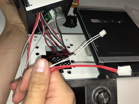

  15. Monoprice Select Mini V2 3D Printer Heating Element and Temperature Sensor Replacement: step 15, image 1 of 3 Monoprice Select Mini V2 3D Printer Heating Element and Temperature Sensor Replacement: step 15, image 2 of 3 Monoprice Select Mini V2 3D Printer Heating Element and Temperature Sensor Replacement: step 15, image 3 of 3
    • Unwind the remaining wire wrap from the bundle of wires.
    • Remove the old heating element and temperature sensor.

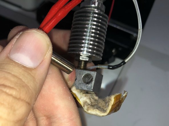

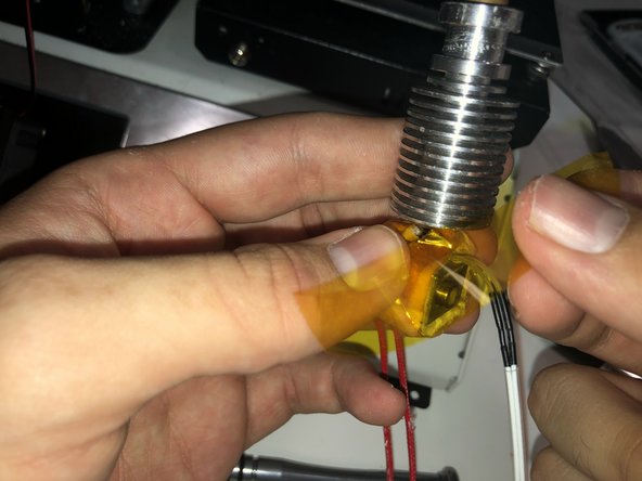

    • Insert the new heating element into the heater block.
    • Tighten the grub screw to secure the heating element.
  17. Monoprice Select Mini V2 3D Printer Heating Element and Temperature Sensor Replacement: step 17, image 1 of 3 Monoprice Select Mini V2 3D Printer Heating Element and Temperature Sensor Replacement: step 17, image 2 of 3 Monoprice Select Mini V2 3D Printer Heating Element and Temperature Sensor Replacement: step 17, image 3 of 3
    • Insert the new temperature sensor into the heater block.
    • If the sensor doesn't stay in place, it may be necessary to apply a small amount of thermal cement to secure it.
  18. Monoprice Select Mini V2 3D Printer Heating Element and Temperature Sensor Replacement: step 18, image 1 of 3 Monoprice Select Mini V2 3D Printer Heating Element and Temperature Sensor Replacement: step 18, image 2 of 3 Monoprice Select Mini V2 3D Printer Heating Element and Temperature Sensor Replacement: step 18, image 3 of 3
    • Use kapton tape to secure the insulation around the heater block.

    • Feed the wires from the new components through the hole at the top of the vertical assembly.
    • From this point, use steps 15-1 as a guide to reassemble the device, ignoring steps 4 and 5.
