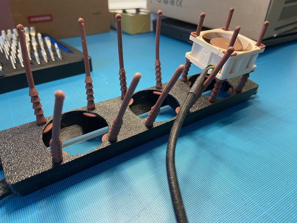

    2. Modixia Cooling Fan Block Preparation - Infinity PC, Installing the pegs: step 2, image 1 of 3 Modixia Cooling Fan Block Preparation - Infinity PC, Installing the pegs: step 2, image 2 of 3 Modixia Cooling Fan Block Preparation - Infinity PC, Installing the pegs: step 2, image 3 of 3
      • Place the brown plastic pegs (images 1 and 2).
      • Press them in (image 3).
      Ask FixBot
    3. Modixia Cooling Fan Block Preparation - Infinity PC, Cooling fan installation: step 3, image 1 of 3 Modixia Cooling Fan Block Preparation - Infinity PC, Cooling fan installation: step 3, image 2 of 3 Modixia Cooling Fan Block Preparation - Infinity PC, Cooling fan installation: step 3, image 3 of 3
      • Orient the cooling fans correctly (with their label facing toward the inside of the block) (image 1).
      • The cooling fan cables must be positioned at the bottom of the block (image 3).
      • Insert them as far as possible so that the cooling fans are securely against the block.
