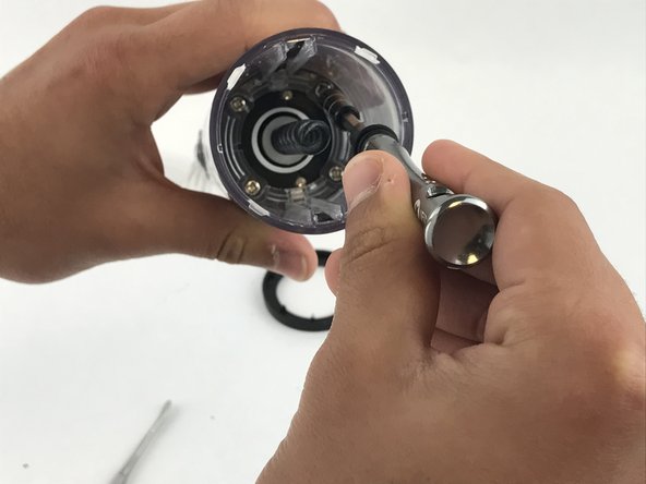

    3. Modal Rechargeable Wine Opener Power Button Replacement: step 3, image 1 of 3 Modal Rechargeable Wine Opener Power Button Replacement: step 3, image 2 of 3 Modal Rechargeable Wine Opener Power Button Replacement: step 3, image 3 of 3
      • Remove all four 4mm screws with a J1 Screwdriver
      • Remove the clear cylindrical cap

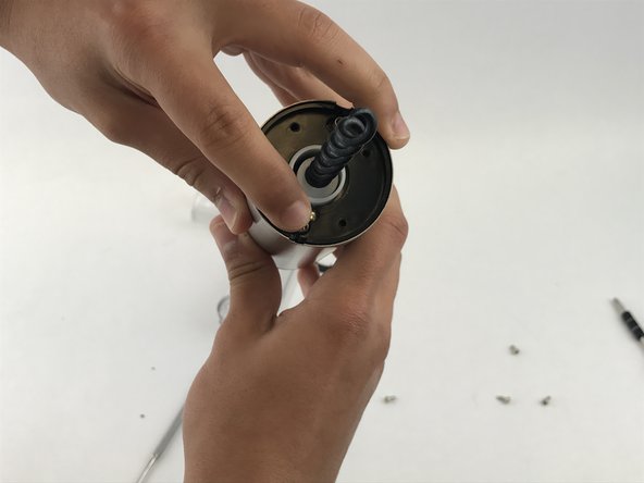

    4. Modal Rechargeable Wine Opener Power Button Replacement: step 4, image 1 of 3 Modal Rechargeable Wine Opener Power Button Replacement: step 4, image 2 of 3 Modal Rechargeable Wine Opener Power Button Replacement: step 4, image 3 of 3
      • Apply pressure to both of the springs on the surface near the corkscrew, releasing the button port.
      Ask FixBot
    5. Modal Rechargeable Wine Opener Power Button Replacement: step 5, image 1 of 3 Modal Rechargeable Wine Opener Power Button Replacement: step 5, image 2 of 3 Modal Rechargeable Wine Opener Power Button Replacement: step 5, image 3 of 3
      • Remove the malfunctioning buttons from the plastic frame.
