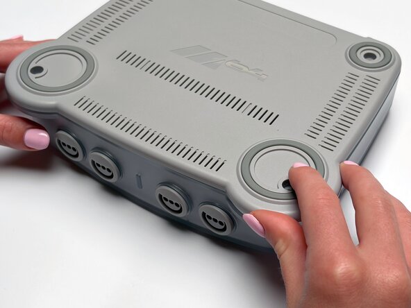

    3. ModRetro M64 Disassembly, Bottom Screws: step 3, image 1 of 3 ModRetro M64 Disassembly, Bottom Screws: step 3, image 2 of 3 ModRetro M64 Disassembly, Bottom Screws: step 3, image 3 of 3
      • Place the device on a soft, flat surface to avoid scratching the top shell.
      • Flip the M64 upside down to access the screws on the bottom.
      • Remove four gamebit 4.5mm screws using the Gamebit 4.5mm Screwdriver.

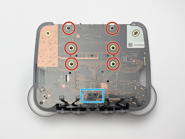

    5. ModRetro M64 Disassembly, PCBA: step 5, image 1 of 3 ModRetro M64 Disassembly, PCBA: step 5, image 2 of 3 ModRetro M64 Disassembly, PCBA: step 5, image 3 of 3
      • Use ESD Protection.
      • Remove six gamebit screws on the PCB using the gamebit 4.5mm Screwdriver.

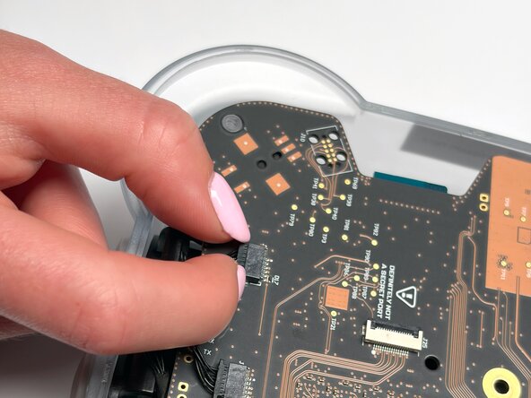

      • Push the opening tool against each pin near the front edge to release and remove the center console light retention tab.
      • Use your fingers to gently remove the 4 cable connectors for the controller port.
      • Carefully lift the PCB away and set aside.

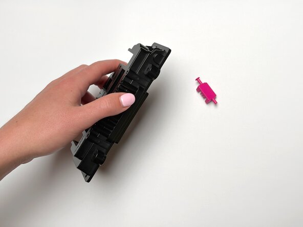

    13. ModRetro M64 Disassembly, Door Lock Button: step 13, image 1 of 2 ModRetro M64 Disassembly, Door Lock Button: step 13, image 2 of 2
      • Flip the cartridge tub upside down to remove the door lock button, then set it aside.
      • For reassembly, ensure the angled top of the button faces upward, then slide the button down into its slot at an angle.
