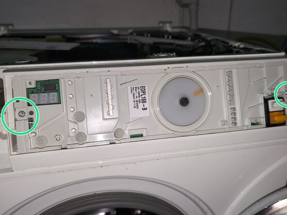

    1. Miele W3 Washing Machine PCB Replacement, Remove the plexiglass cover: step 1, image 1 of 3 Miele W3 Washing Machine PCB Replacement, Remove the plexiglass cover: step 1, image 2 of 3 Miele W3 Washing Machine PCB Replacement, Remove the plexiglass cover: step 1, image 3 of 3
      • Unplug the power cord
      • Open the lid (see separate guide). This is not strictly necessary, but it helps to ensure that no cables are pinched during reassembly
      • Pull the knob off by wiggling it forward with your hand
      • Using a sharp putty knife, insert it horizontally into one side of the plexiglass cover, and carefully twist the knife upward. Gently pry the plexiglass forward. Repeat this at several points until the cover can be pulled away upward.
      • Release the T20 Torx screw on the left and right
      • The control unit can then be pulled out. Unplug the hose for the force sensitive squeeze button

    2. Miele W3 Washing Machine PCB Replacement, Exposing the control unit: step 2, image 1 of 3 Miele W3 Washing Machine PCB Replacement, Exposing the control unit: step 2, image 2 of 3 Miele W3 Washing Machine PCB Replacement, Exposing the control unit: step 2, image 3 of 3
      • Pressing this retaining tab releases the main switch, which can then be pulled down slightly. There is a small plastic cap over the main switch terminals on the underside that can be easily removed.
      • Check once more that the power plug is disconnected, then unplug the brown power supply cable and the black power supply for the PCB from the main switch.
      • Afterwards, the main switch can be slid downwards. From below, unplug the door opener connector to the left of the switch PCB.

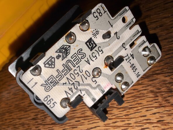

    3. Miele W3 Washing Machine PCB Replacement, Checking the main switch (optional): step 3, image 1 of 1
      • If the household washing machine was not functioning, be sure to test the switch with a multimeter. When switched off, all sockets must have high resistance relative to one another.
      • When the white 'On' switch is pressed (it must be a latching switch), socket 1 should have low resistance to socket 3, and socket 2 should have low resistance to socket 4.
      • When the orange door release button is pressed (momentary), there must be low resistance between socket 4 and socket 5.
      • On the other side of the switch, there is also a 6.3A fuse. Check for continuity.
