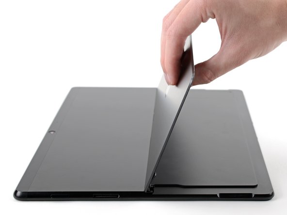

  7. Microsoft Surface Pro X Kickstand Replacement, Lift the kickstand: step 7, image 1 of 3 Microsoft Surface Pro X Kickstand Replacement, Lift the kickstand: step 7, image 2 of 3 Microsoft Surface Pro X Kickstand Replacement, Lift the kickstand: step 7, image 3 of 3
    • Lift the kickstand to about a 90° angle.

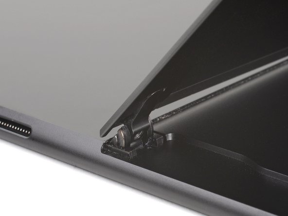

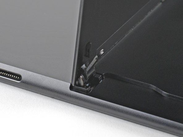

  8. Microsoft Surface Pro X Kickstand Replacement, Remove the kickstand hinge screws: step 8, image 1 of 2 Microsoft Surface Pro X Kickstand Replacement, Remove the kickstand hinge screws: step 8, image 2 of 2
    • Use a T3 Torx screwdriver to remove two 2.5 mm screws securing the kickstand to the kickstand hinges.

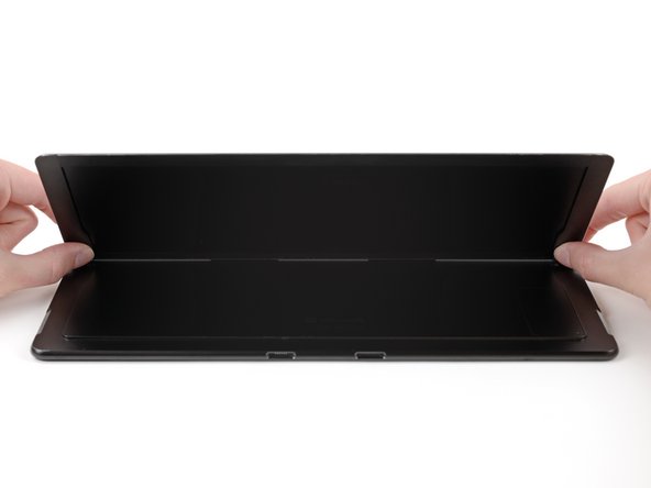

  9. Microsoft Surface Pro X Kickstand Replacement, Remove the kickstand: step 9, image 1 of 2 Microsoft Surface Pro X Kickstand Replacement, Remove the kickstand: step 9, image 2 of 2
    • Hold both hinges and the kickstand.
    • Move the kickstand down to a 45° angle.

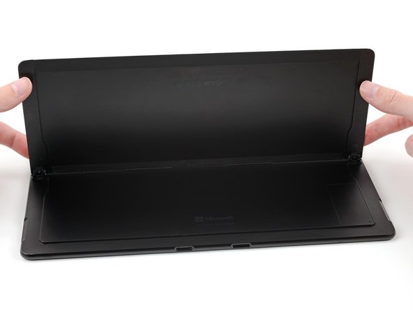

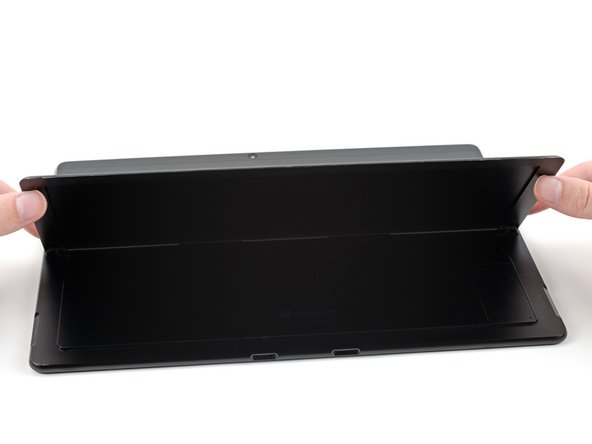

  10. Microsoft Surface Pro X Kickstand Replacement: step 10, image 1 of 3 Microsoft Surface Pro X Kickstand Replacement: step 10, image 2 of 3 Microsoft Surface Pro X Kickstand Replacement: step 10, image 3 of 3
    • Hold the kickstand by the center of its bottom edge.
    • Move the kickstand up by about 10° to detach the kickstand's screw bosses from the hinges.
    • During reassembly, make sure the hinges are fully inserted into their recesses in the kickstand. Follow the instructions in the next step to reinsert the hinges.
