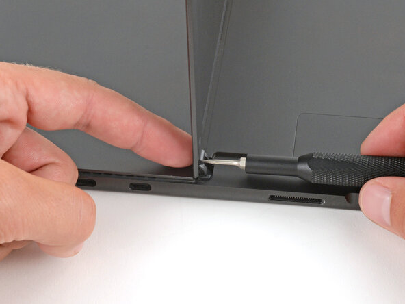

    1. Microsoft Surface Pro 8 Kickstand Replacement, Remove the hinge screws: step 3, image 1 of 3 Microsoft Surface Pro 8 Kickstand Replacement, Remove the hinge screws: step 3, image 2 of 3 Microsoft Surface Pro 8 Kickstand Replacement, Remove the hinge screws: step 3, image 3 of 3
      • While holding the kickstand behind the hinge with your finger, use a Torx Plus 3IP screwdriver to remove the 2.4 mm‑long screw from each hinge (two total).

    2. Microsoft Surface Pro 8 Kickstand Replacement, Lower the kickstand: step 4, image 1 of 2 Microsoft Surface Pro 8 Kickstand Replacement, Lower the kickstand: step 4, image 2 of 2
      • Firmly grip the hinges and kickstand between your thumb and index fingers.
      • Lower the kickstand down to about 45 degrees.
      • This may take a bit of force. Be careful not to pinch your thumbs.
