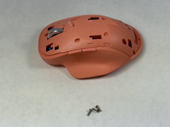

    3. Microsoft Bluetooth Ergonomic Mouse Shell Disassembly: step 3, image 1 of 2 Microsoft Bluetooth Ergonomic Mouse Shell Disassembly: step 3, image 2 of 2
      • Remove the three 7.1 mm T6 Torx screws securing the inner shell.
      Ask FixBot
    4. Microsoft Bluetooth Ergonomic Mouse Shell Disassembly: step 4, image 1 of 2 Microsoft Bluetooth Ergonomic Mouse Shell Disassembly: step 4, image 2 of 2
      • Open the inner shell carefully from left to right to access the internal circuits.
      • Do not pull on the wires connecting the upper and lower shell components.
