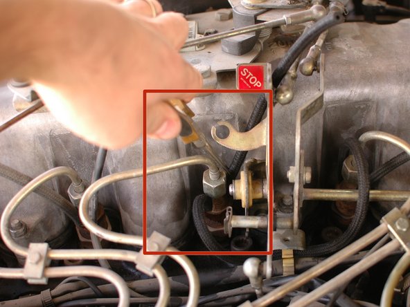

      • As shown here, the injector return lines go from one injector to the next.
      • And then they stop with a plug at the rearmost injector, closest to the firewall.

      • The lines should simply pull off of the injector nipples.
      • These lines were fairly stiff, but not brittle yet. However, it's a good time to replace them. Once they become brittle the can become very hard to remove. They will break off at the nipple and they will need to be cut off with a razor blade, very carefully, to avoid scoring the metal nipples.
