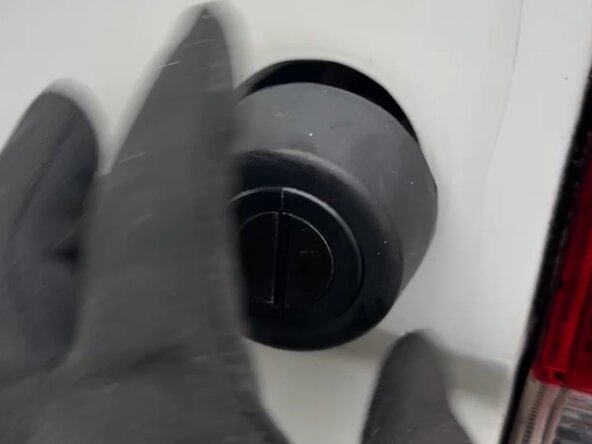

Hey everyone, very simple guide here for you.
The old magnets that keep the doors fully open had disintegrated over the years. I bought brand new ones to replace them.
It was as simple as removing the old ones with a grip tool due to how bad they had got. Normally you would use a larger grip tool or your hands if you're strong enough.
What you can also do is go to the inside and release the tension on the screws to make this easier.
Once this is off, simply clean around the area and inside the hole and remove and residue.
You can now attach the new magnet by screwing it in place and then tightening the screws on the inside.

    1. Mercedes Sprinter Door Magnets Replacement, REMOVE OLD MAGNET: step 1, image 1 of 1
      • Remove the old Magnet using some grips or your hands. Please wear suitable PPE.
