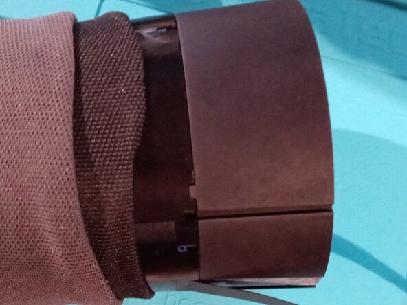

    2. Meeting Owl Lens Replacement, Accessing the base: step 2, image 1 of 3 Meeting Owl Lens Replacement, Accessing the base: step 2, image 2 of 3 Meeting Owl Lens Replacement, Accessing the base: step 2, image 3 of 3
      • The base can be accessed by first removing the rubber band on which the Meeting Owl sits. It is simply glued, so it can be removed without any special tool.
      • Once removed, it gives access to four Phillips screws retaining the base to the rest of the device.
      • When opening the base, be aware of the ribbon cable and the cables connecting the speaker.

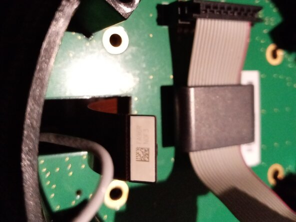

    3. Meeting Owl Lens Replacement, Disconnecting the base: step 3, image 1 of 2 Meeting Owl Lens Replacement, Disconnecting the base: step 3, image 2 of 2
      • The speaker can be disconnected by simply pulling off the connector from the PCB.
      • The ribbon cable, providing power and carrying the data between the USB port and the Qualcomm CPU, is retained by a latch connector. Using tweezers or the tip of a plastic stick, flip up the latch to release the ribbon cable.
      Ask FixBot

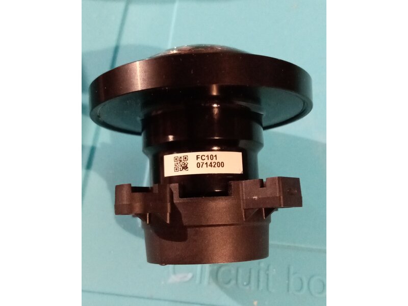

    23. Meeting Owl Lens Replacement, Separating the lens from its adaptor: step 23, image 1 of 3 Meeting Owl Lens Replacement, Separating the lens from its adaptor: step 23, image 2 of 3 Meeting Owl Lens Replacement, Separating the lens from its adaptor: step 23, image 3 of 3
      • The lens and the adaptor are kept together by two means. For one, the base of the lens is threaded and screwed into the adaptator. Second, they are glued together by what looks like hot glue applied at their junction (not visible on the pictures since it had already been removed).
      • To separate them, the glue must first be removed. Simply slide a sharp tool behind the glue and slowly pry it. Take care to not cause damage to the lens and its surrounding.
      • Then unscrew the lens from the adaptor.

    1. Meeting Owl Lens Replacement, Adjusting the focus: step 24, image 1 of 3 Meeting Owl Lens Replacement, Adjusting the focus: step 24, image 2 of 3 Meeting Owl Lens Replacement, Adjusting the focus: step 24, image 3 of 3
      • Since the lens has no official replacement part, one must first find a "donor" Meeting Owl. The MTW100 and MTW200 share the same lens and can be used as donor.
      • However, the MTW100 and MTW200 don't have the same camera resolution (720p VS 1080p). So the lens, its adaptor and the sensor glued to it can't be simply swapped from one generation to the other. (it is unknow if a MTW200 sensor would work properly on a MTW100). The sensor must be pried off the adaptator by pushing one of its corner.
      • The good sensor can be glued back by putting a small amount of glue (super glue) at the junction of the sensor to the adaptor. However, one could choose to keep the sensor in place using the thermal pad on the metal retainer side.
      • And since the lens transplant will must likely result in an unfocused image, the MTW100 must be reassemble before correcting its focus. While displaying the video from the camera in your favorite app, slightly turn the metal ring around the lens clockwise or counter-clockwise to find the sweet spot where the image is the sharpest.
      • One could disassemble the whole device once more to glue back the lens to the adaptor. This will prevent loosing the focus again or completely removing the lens off from the Meeting Owl. However, knowing how to adjust the focus by rotating the lens from the top of the dome allows us to keep it as is.
