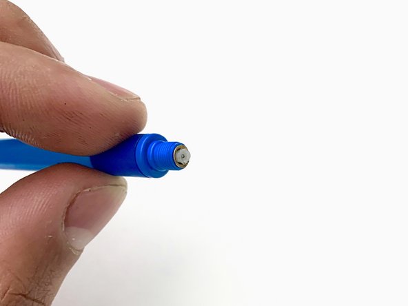

    4. Mechanical Pencil Spring Replacement: step 4, image 1 of 2 Mechanical Pencil Spring Replacement: step 4, image 2 of 2
      • Depress the shaft into the sleeve.
      Ask FixBot

    6. Mechanical Pencil Spring Replacement: step 6, image 1 of 3 Mechanical Pencil Spring Replacement: step 6, image 2 of 3 Mechanical Pencil Spring Replacement: step 6, image 3 of 3
      • Use pliers to grasp the dispenser perpendicular to the open split.
      • Apply pressure and pull the dispenser straight out from the shaft and sleeve. This may be difficult.
      • If the dispenser is grasped incorrectly it could cause damage.
      • Be careful not to lose or bend the dispenser ring in the process. It is small and fragile.
      Ask FixBot
