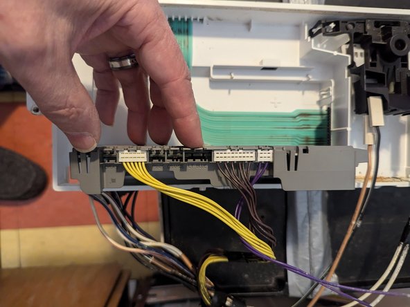

    5. Maytag Dishwasher Control Board Replacement, Remove the Control Board Cover: step 5, image 1 of 3 Maytag Dishwasher Control Board Replacement, Remove the Control Board Cover: step 5, image 2 of 3 Maytag Dishwasher Control Board Replacement, Remove the Control Board Cover: step 5, image 3 of 3
      • The control board cover is held on by two latches, one on either side. The first one is shown on the opposite side near the bundle of wires.
      • The other latch can be seen directly below my thumb in the second photo; simply press in to release it.
      • The cover is now free and can be removed and set aside.

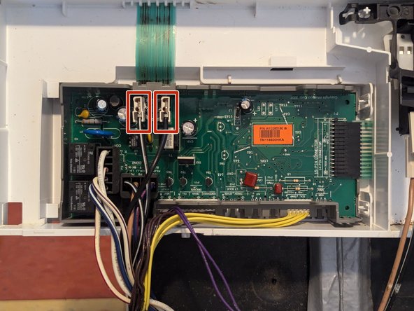

    6. Maytag Dishwasher Control Board Replacement, Unplug the Board Connectors: step 6, image 1 of 2 Maytag Dishwasher Control Board Replacement, Unplug the Board Connectors: step 6, image 2 of 2
      • Remove the two wires connected to the Thermal Fuse. Note that they can be difficult to unplug and you may have to hold the fuse down with one hand to avoid pulling it out of its bracket.
      • Unplug the two large power connectors by grasping the black plastic part of the connector and pulling straight up on both of them.

    8. Maytag Dishwasher Control Board Replacement, Unplug the Edge Connectors: step 8, image 1 of 3 Maytag Dishwasher Control Board Replacement, Unplug the Edge Connectors: step 8, image 2 of 3 Maytag Dishwasher Control Board Replacement, Unplug the Edge Connectors: step 8, image 3 of 3
      • Three edge connectors remain. Flip the board around and set it on edge to access them.
      • Each connector is held in with a single latch; bend the latch slightly then carefully grasp the wires and lift straight up to remove the connector.
      Ask FixBot
    9. Maytag Dishwasher Control Board Replacement: step 9, image 1 of 3 Maytag Dishwasher Control Board Replacement: step 9, image 2 of 3 Maytag Dishwasher Control Board Replacement: step 9, image 3 of 3
      • Remove the remaining two connectors.
      • The edge connectors are different sizes and the wires are color coded, so you have to work at it to get the connectors wrong, since each one is labelled according to color.
