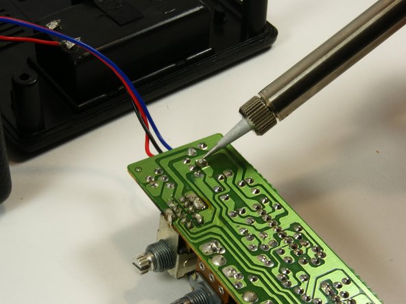

      • Now you must remove the LED from the circuit board.
      • To do this you will need to use a soldering iron to detach to two pins of the LED from the board. They are the two pins in the lowest leftmost corner of the board.
      • Be careful to not touch any of the wires with the soldering iron. It might be helpful to remove those with the iron first to get them out of the way.
      • If you haven't soldered before check out this guide.
      • Once detached, pull the board straight up to remove.

    1. Marshall MS-2 Electrical Component Replacement, Electrical Component: step 7, image 1 of 2 Marshall MS-2 Electrical Component Replacement, Electrical Component: step 7, image 2 of 2
      • First do a visual check. Looked for cracked solder or damaged components.
      • The image on this page shows a wire who's solder has completely detached from the board.
      • To fixed cracked or detached solder, use the soldering iron to heat the solder already there until it flows and becomes completely attached to the board.
      • To replace damaged components use the iron to remove and replace them.
