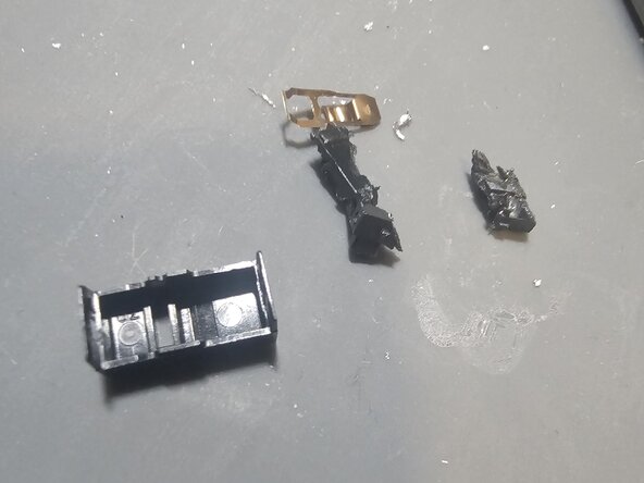

    5. Main Click Buttons: step 5, image 1 of 3 Main Click Buttons: step 5, image 2 of 3 Main Click Buttons: step 5, image 3 of 3
      • Use pliers to grip and remove the black covers over the button — the black cover and the button, a small white plastic piece, should come off).

    6. Main Click Buttons: step 6, image 1 of 1
      • use side cutters to carefully diassasemble remaining plastic part of switch careful not to damage motherboard

you have to buy new ones… i’m more concerned of using pliers to take the switch apart, when ideally you should desolder it and replace it with a proper omron switch (not made in china)
Erick Alonso Duque - Reply Share
He is only removing the cover, not the whole button. But doing it with pliers is skipping that it has two clips, one at each end and you could damage the board just twisting and pulling

What do you do after step 5? And that copper spring looks wrong. It shouldn’t look like that. The correct positioning is this: https://community.pcgamingwiki.com/galle...
