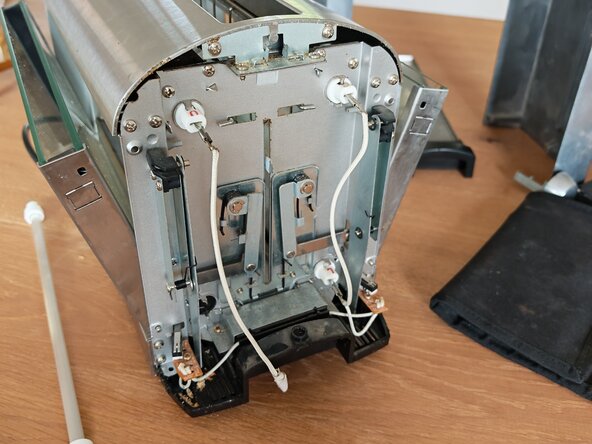

    3. Magimix Vision Toaster - heating element replacement, Heating Element Removal: step 3, image 1 of 2 Magimix Vision Toaster - heating element replacement, Heating Element Removal: step 3, image 2 of 2
      • The ends of the four heating elements are visible on each side.
      • Unplug the spade terminals on both ends of the Heating Element that you want to replace. At the 'knob' end, bend the flat spade part of the element horizontal so that it can slide through the toaster.
      • The heating element is held in place on the frame by tabs. At the non-knob end, carefully bend open the 2 tabs which hold the heating element in place. Slide out the old heating element (towards the non-knob end of the toaster)
      • If the heating element is broken inside the device, remove all the pieces.
