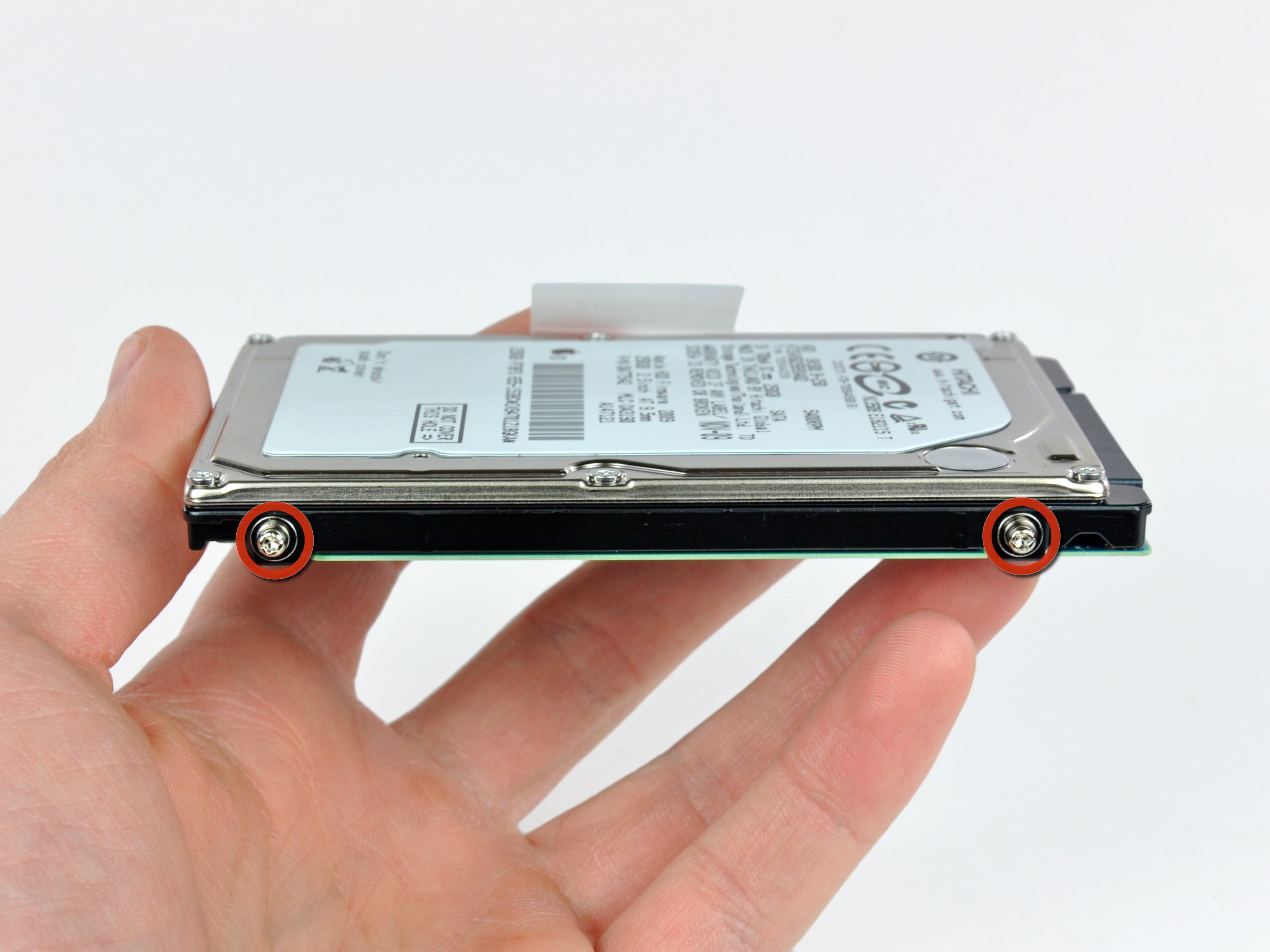

  8. MacBook Unibody Model A1342 Hard Drive Replacement, Hard Drive: step 8, image 1 of 1
    • Remove the two T6 Torx screws from each side of the hard drive (four screws total).
    • You'll need to transfer these screws to your new hard drive if you're changing drives.
    • If you are installing a new hard drive, we have an OS X install guide to get you up and running.
