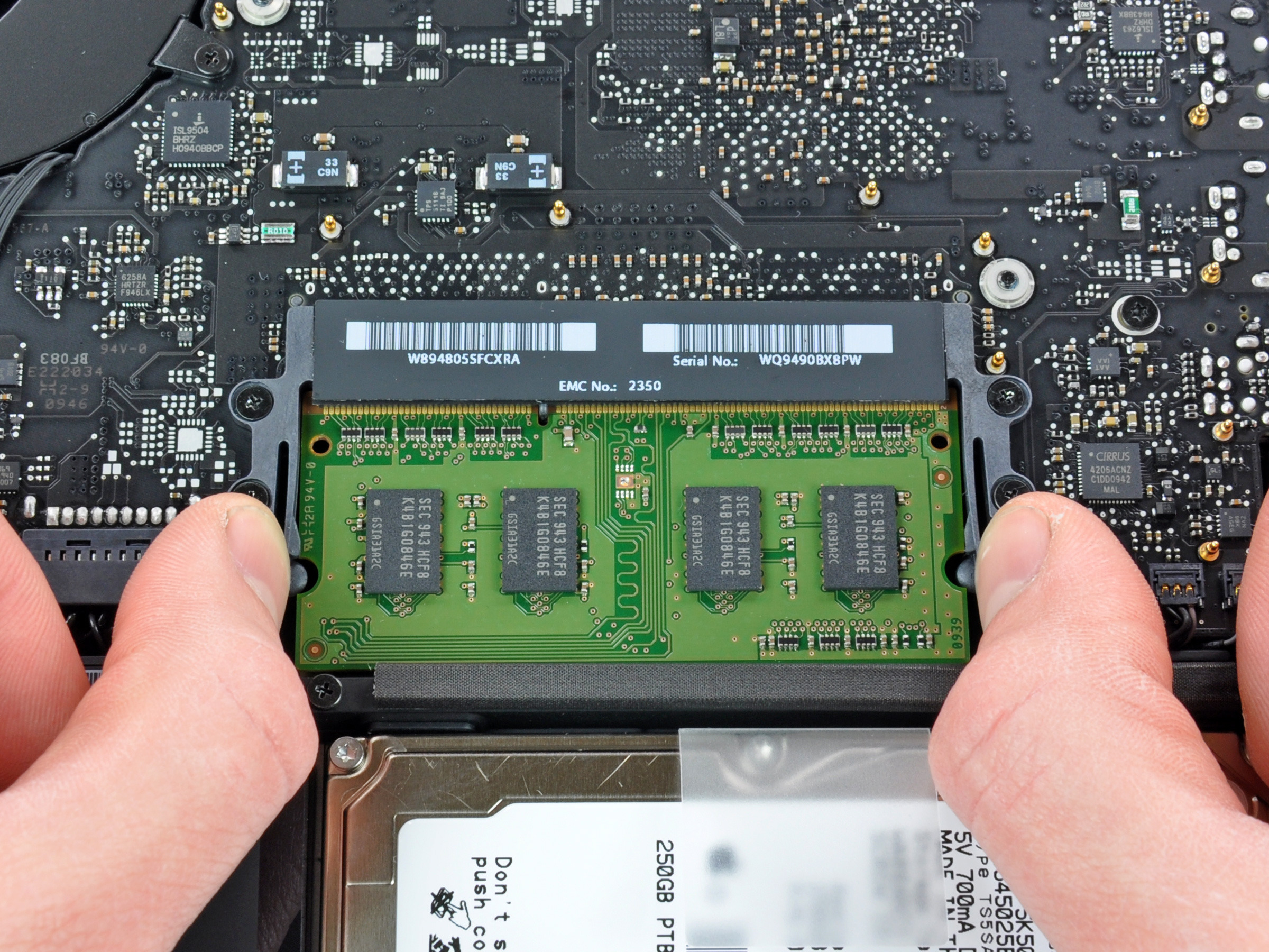

    1. MacBook Unibody Model A1342 RAM Replacement, RAM: step 4, image 1 of 1
      • Release the tabs on each side of the chip by simultaneously pushing each tab away from the RAM.
      • These tabs lock the chip in place and releasing them will cause the chip to "pop" up.
      Ask FixBot
    2. MacBook Unibody Model A1342 RAM Replacement: step 5, image 1 of 1
      • After the RAM module has popped up, pull it straight out of its socket.
      • Repeat this process if a second RAM module is installed.
      Ask FixBot
