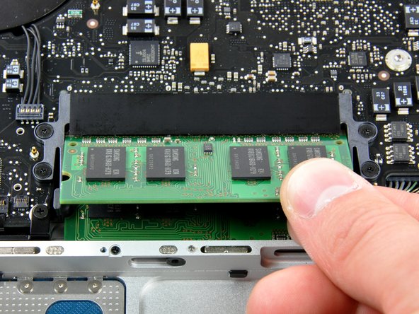

    1. MacBook Unibody Model A1278 RAM Replacement, RAM: step 6, image 1 of 1
      • Release the tabs on each side of the chip by simultaneously pushing each tab away from the RAM.
      • These tabs lock the chip in place and releasing them will cause the chip to "pop" up.
      Ask FixBot
    2. MacBook Unibody Model A1278 RAM Replacement: step 7, image 1 of 1
      • After the RAM chip has popped up, pull it straight out of its socket.
      • Repeat this process if a second RAM chip is installed.
      Ask FixBot

Open back of unit, press two grey sides surrounding the chip, pull out the top (leave the bottom 2gb in) put in the new (4gb) chip; now there are 6gb of ram.
mrstiffanyjudson - Reply Share
I just upgraded to 2 4GB chips. Works fine sofar!
Sten Folkerman - Reply Share
That's awesome! I thought that I could only upgrade the RAM to 4GB (which is what I have now). Can you give me the type of RAM that you installed? I have this exact model MacBook.
Jonathan - Reply Share
Uh oh. I replaced my 2 1GB ram with 2 2GB. I turned it on and it beeps at me about every second, the front status light blinks in time, but nothing else....what next?
dunkelcreature - Reply Share
Sounds like bad RAM. I would contact who you purchased it from. If it was us, email support [at] ifixit [dot] com
