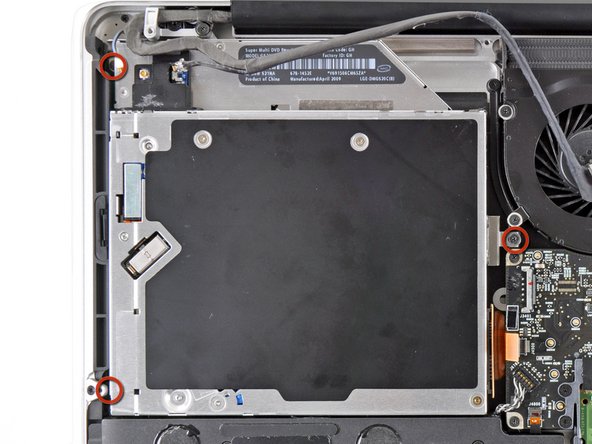

Remove the three 3.5 mm Phillips screws securing the optical drive to the upper case.
Remove the optical drive from the upper case, minding any cables that may get caught.

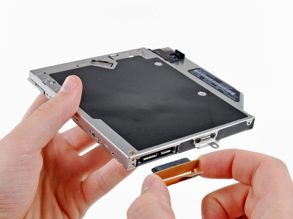

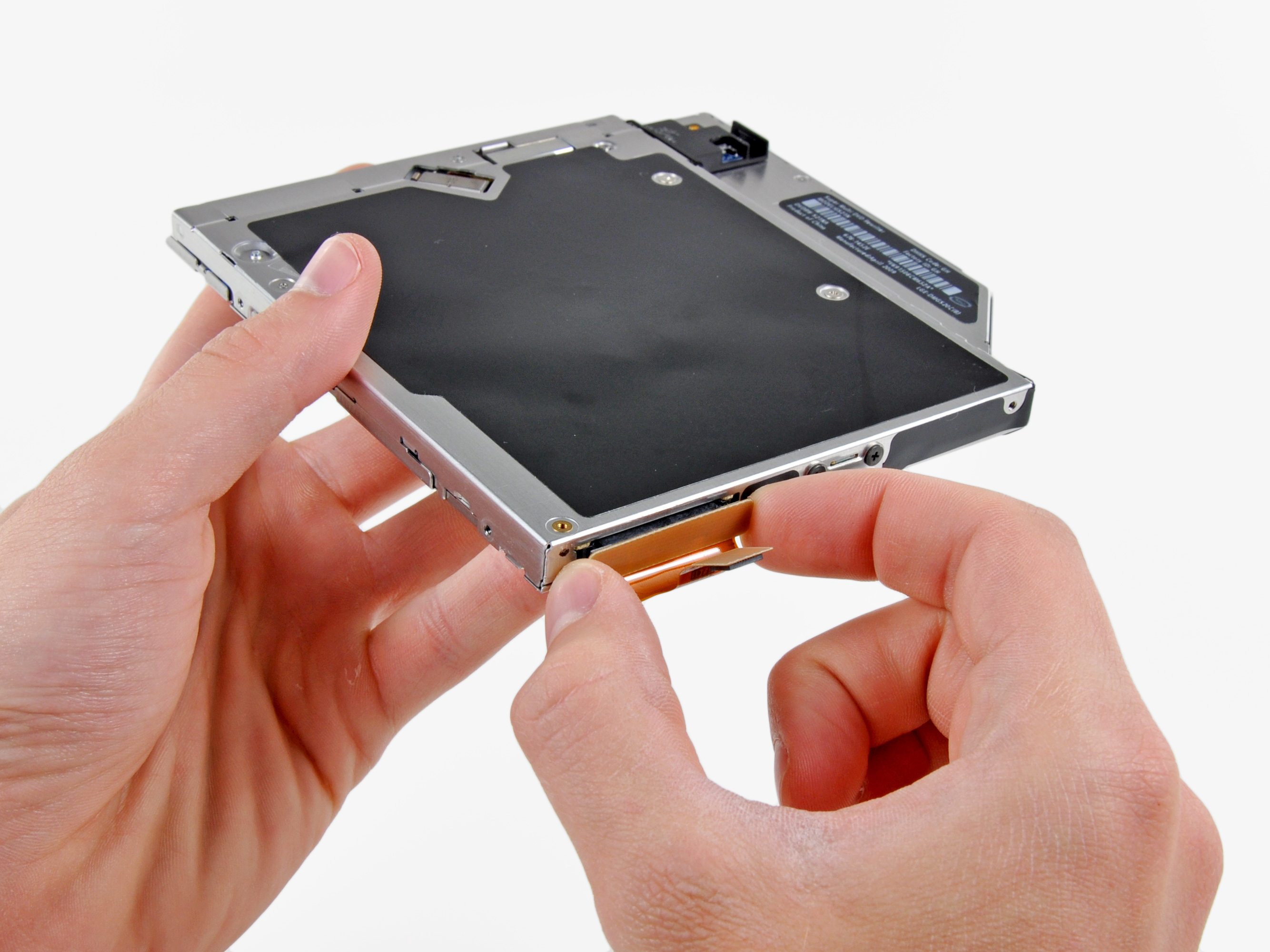

Grab the optical drive cable by its connector and pull it away from the body of the hard drive.

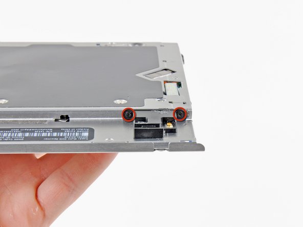

Remove the two black Phillips #0 screws securing the small metal mounting bracket. Transfer this bracket to your new optical drive or hard drive enclosure.

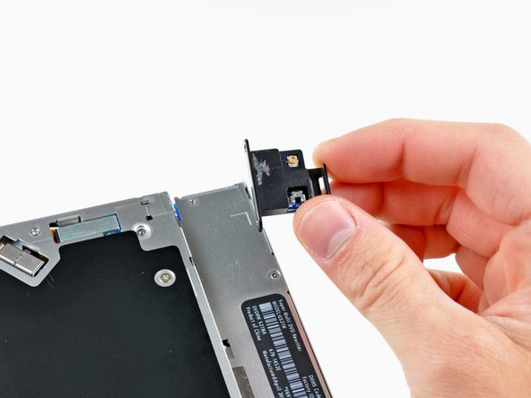

Remove the two 2.2 mm Phillips screws securing the Bluetooth board to the side of the optical drive.

Once again, this step, and the rest that follow regarding the bluetooth board, bears no resemblance to my A1297. Luckily, it looks like things have been made simpler. Remove the camera cable from it's socket, the bluetooth cable (flat, black, just shy of .5" wide), and the DVD cable from their sockets. Remove the screw from the top right side of the black plastic piece that holds the bluetooth board and all the skinny black cables. Remove the screw at the top of this piece that fastens to the hinge (look for the shiny metal). Then just lift that piece out of the way, remove the 3 screws holding the DVD in place, and you can pull the drive out (I just grab it by the orange cable and pull it out, but that's probably not the preferred method).

mid 2010 A1297 again. Different configuration. I had a black plastic housing along this whole side. The large flat ribbon connects to it and I LEFT THE RIBBON IN PLACE on this housing. I removed 3 screws here to allow this black housing to be lifted off the drive and to the side, along with the camera line (held down by 3rd screw). When REPLACING this black housing after installation is complete, note there is a small tab on the disc slot side of the housing that needs to be inserted into a slot for correct placement. Then SKIP TO STEP 10 on this IFIXIT tutorial.

Step 16 ((NEW)) (unless I am crazy, this was not detailed). After removing original drive, remove bracket (2 screws) from its side, and reuse on new drive. If you are confused which bracket, the drive is held in place with 3 screws. The 3rd screw on the center of the logic board side, goes through this bracket that you need to reuse. Top view of bracket can also be seen in Step 11 picture.

what happens to the bluetooth board once you've removed it?
Jayke Wright - Reply
install it on the new drive
scottbernardis -
