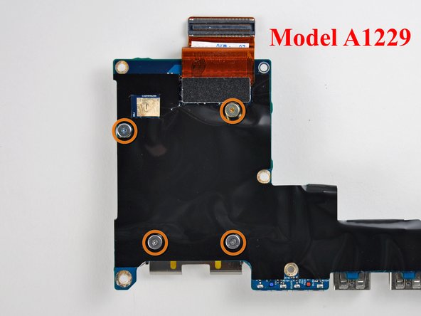

  22. MacBook Pro 17" Models A1151 A1212 A1229 and A1261 ExpressCard Cage Replacement: step 22, image 1 of 2 MacBook Pro 17" Models A1151 A1212 A1229 and A1261 ExpressCard Cage Replacement: step 22, image 2 of 2
    • Remove the following four screws:
    • One 3.2 mm black Phillips screw with a small head.
    • Three 1.3 mm silver Phillips screws with large heads.
    • The ExpressCard cage is now free from the left I/O board.
    • If you have a MacBook Pro 17" Model A1229, remove the four 1.3 mm silver Phillips screws with large heads.
