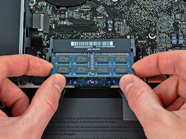

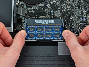

    1. MacBook Pro 15" Unibody Mid 2009 RAM Replacement, RAM: step 3, image 1 of 2 MacBook Pro 15" Unibody Mid 2009 RAM Replacement, RAM: step 3, image 2 of 2
      • Release the tabs on each side of the chip by simultaneously pushing each tab away from the RAM.
      • These tabs lock the chip in place and releasing them will cause the chip to "pop" up.
      • After the RAM chip has popped up, pull it straight out of its socket.
      • Repeat this process if a second RAM chip is installed.

I replaced my original 2x 2gb ram with 2x 4gb RAM following your instructions. However, upon boot up, it’s only showing 1 of the 2 4gb chips. Any tips on how to get both seated correctly?
Matthew Longo - Reply Share
Never mind. I was able to pop the second chip back out and get it seated properly.
