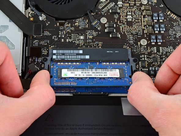

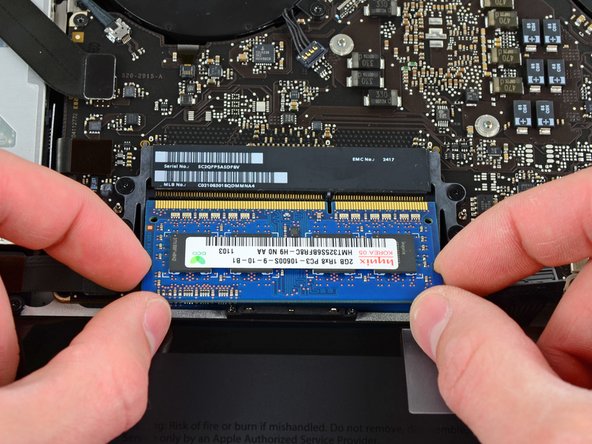

    1. MacBook Pro 15" Unibody Late 2011 RAM Replacement, RAM: step 5, image 1 of 3 MacBook Pro 15" Unibody Late 2011 RAM Replacement, RAM: step 5, image 2 of 3 MacBook Pro 15" Unibody Late 2011 RAM Replacement, RAM: step 5, image 3 of 3
      • Release the tabs on each side of the RAM chip by simultaneously pushing each tab away from the RAM module.
      • These tabs lock the chip in place and releasing them will cause the chip to "pop" up.
      • After the RAM chip has popped up, pull it straight out of its socket.
      • Repeat this process if a second RAM chip is installed.
