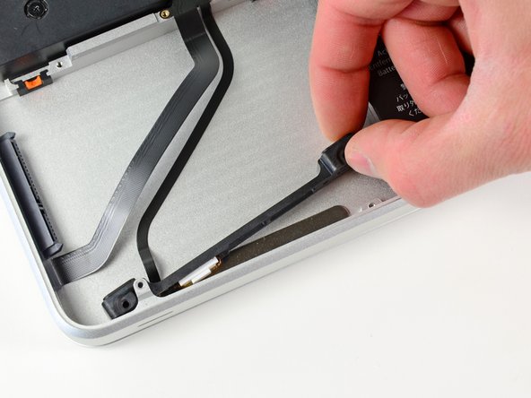

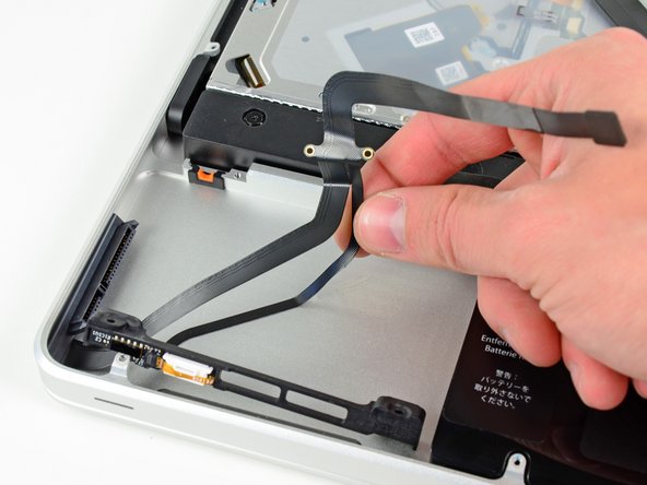

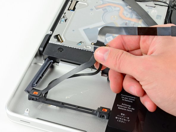

Image 1/1: Two 1.5 mm Phillips screws.
  • Remove the following four screws securing the hard drive and IR sensor cable to the upper case:
    • Two 1.5 mm Phillips screws.
    • Two 4 mm Phillips screws.
Image 1/3: Carefully peel the hard drive and IR sensor cable from the upper case.
  • Slide the hard drive and IR sensor bracket away from the edge of the upper case.
  • Carefully peel the hard drive and IR sensor cable from the upper case.
  • Lift the hard drive and IR sensor assembly out of the upper case.

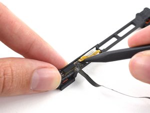

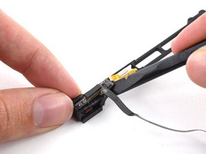

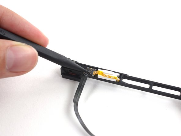

Image 1/3: Use the tip of a spudger to flip the ZIF connector on the hard drive cable.
  • Your replacement part may or may not come with the front (sensor) bracket. If it does not, you'll need to transfer it to your new cable.
  • Use the tip of a spudger to flip the ZIF connector on the hard drive cable.
  • Gently pull the sensor bracket cable out of the ZIF connector.
  • Use the flat end of a spudger to pry the hard drive cable up off the sensor bracket.
  • Remove the adhesive backing from your new hard drive cable, stick it onto the sensor bracket, and connect the sensor bracket cable.
