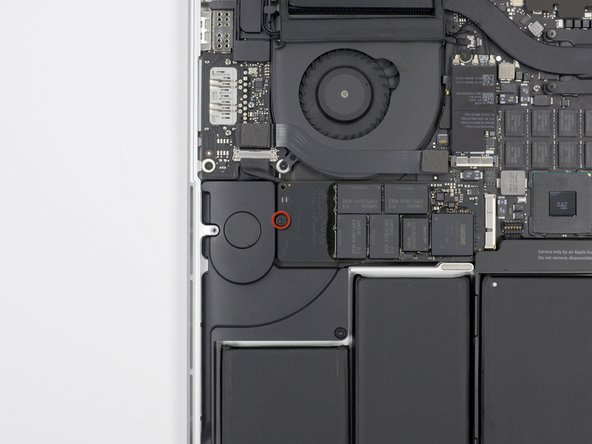

    1. MacBook Pro 15" Retina Display Mid 2012 SSD Replacement, SSD: step 5, image 1 of 1
      • Remove the single 3.1 mm T5 Torx screw securing the SSD to the logic board.

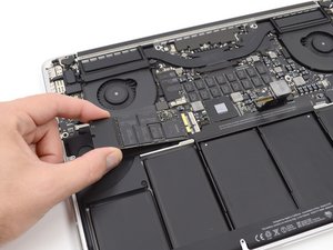

    2. MacBook Pro 15" Retina Display Mid 2012 SSD Replacement: step 6, image 1 of 1
      • Slightly lift the leftmost side of the SSD and firmly slide it straight away out of its socket on the logic board.
