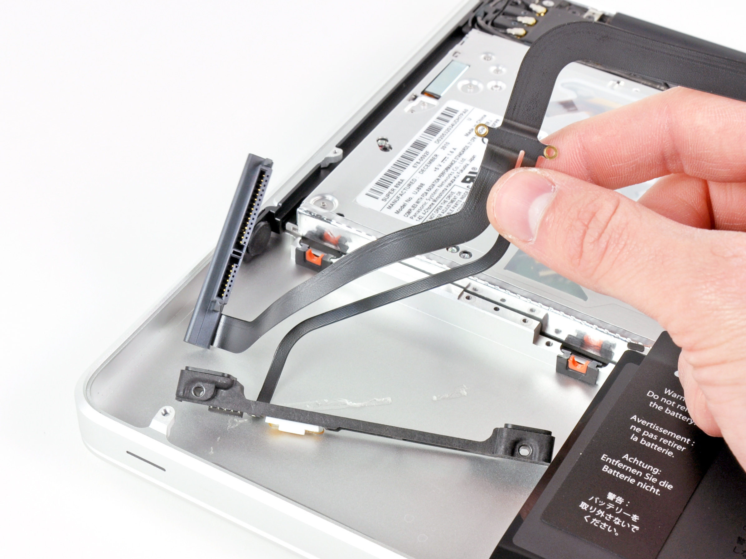

Remove the following ten screws:
Three 14.4 mm Phillips #00 screws
Three 3.5 mm Phillips #00 screws
Four 3.5 mm shouldered Phillips #00 screws
Use your fingers to pry the lower case away from the body of the MacBook near the vent.
Remove the lower case.
Use the edge of a spudger to pry the battery connector upwards from its socket on the logic board.
Bend the battery cable slightly away from its socket on the logic board so it does not accidentally connect itself while you work.
Remove the two Phillips screws securing the hard drive bracket to the upper case.
Pull the hard drive cable away from the body of the hard drive.
Remove the hard drive.
Use the flat end of a spudger to pry the hard drive cable connector up from its socket on the logic board.
Remove the following four screws:
Two 3 mm Phillips screws
Two 9.7 mm Phillips screws
Carefully peel up the thin IR sensor/sleep LED ribbon cable from the adhesive securing it to the upper case.
Pull the front hard drive bracket containing the IR sensor/sleep LED away from the front edge of the upper case.

Step 14: Note how far in the yellow tab of the sensor bracket cable goes into the ZIF connector before pulling it out. Reinserting was a little difficult, but looking at the photo at full size helped. When all the way in, there will be a line of gold running just in front of the connector. Overall, great instructions and photos. Thank you so much.

I'm finding that it's pretty much impossible to remove the two 3mm screws holding the cable down. Any hints on that?
Andrew Huey - Reply
Step 13
The replacement cable comes without the sleep led attached. Thus you have to remove the flat cable of the sleep led from the socket of the old hd cable. Take your fingernail and lift the side of the socket opposite to the cable. It's really tiny! Afterwards insert the new cable and push gently on the part lifted up before.
Skyynet - Reply

prall -
it's not clear whether the new cable should come with a new bracket or the old one is also fine ? here in europe most hdd cables ship without bracket
natalie - Reply
Yes, this was fiddly and it needs extra photos. I only got this done with the aid of a magnifying glass.
John Walker - Reply
Step 14
This section is backwards, do not try to remove the IR sensor ZIF connector until you have removed the hard drive cable gently from the bracket as @Skyynet says above, by using a "fingernail (or the spudger) and lift the side of the socket opposite to the cable" gently, it's glued on. Then you can wiggle the ZIF connector off of the hard drive cable with your fingers.
bwanamarko - Reply
My apologies, I was incorrect in my previous comment. The ZIF connector is a little flap on the hard drive cable that can be opened by flipping it up. This makes extracting the IR sensor easier. Removing the hard drive cable from the bracket may also make removing the IR sensor from the ZIF connector, but only if you've opened the flap. The new cable should already have the flap of the ZIF connector open, so make sure to close it. But does anyone know how you can tell if the IR sensor is connected? It's so small it's hard to tell if it can slide in further.
bwanamarko - Reply
Also note there are 3 photos in this step, you can view them by hovering over each one. Click to enlarge.
bwanamarko - Reply
Very nice set of close up photos of the hard drive cable IR sensor ZIF connectory are here: https://discussions.apple.com/thread/708...
bwanamarko - Reply
I would recommend using tweezers that come with the ifixit tool kit to properly insert the sensor bracket cable back into the sensor bracket. I had trouble with my computer in which the solution was that this step was not executed properly in my repair of the hard drive cable installation. I encourage everyone to make sure the bracket is fully and properly put back in the bracket otherwise the hard drive will appear to malfunction.
