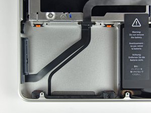

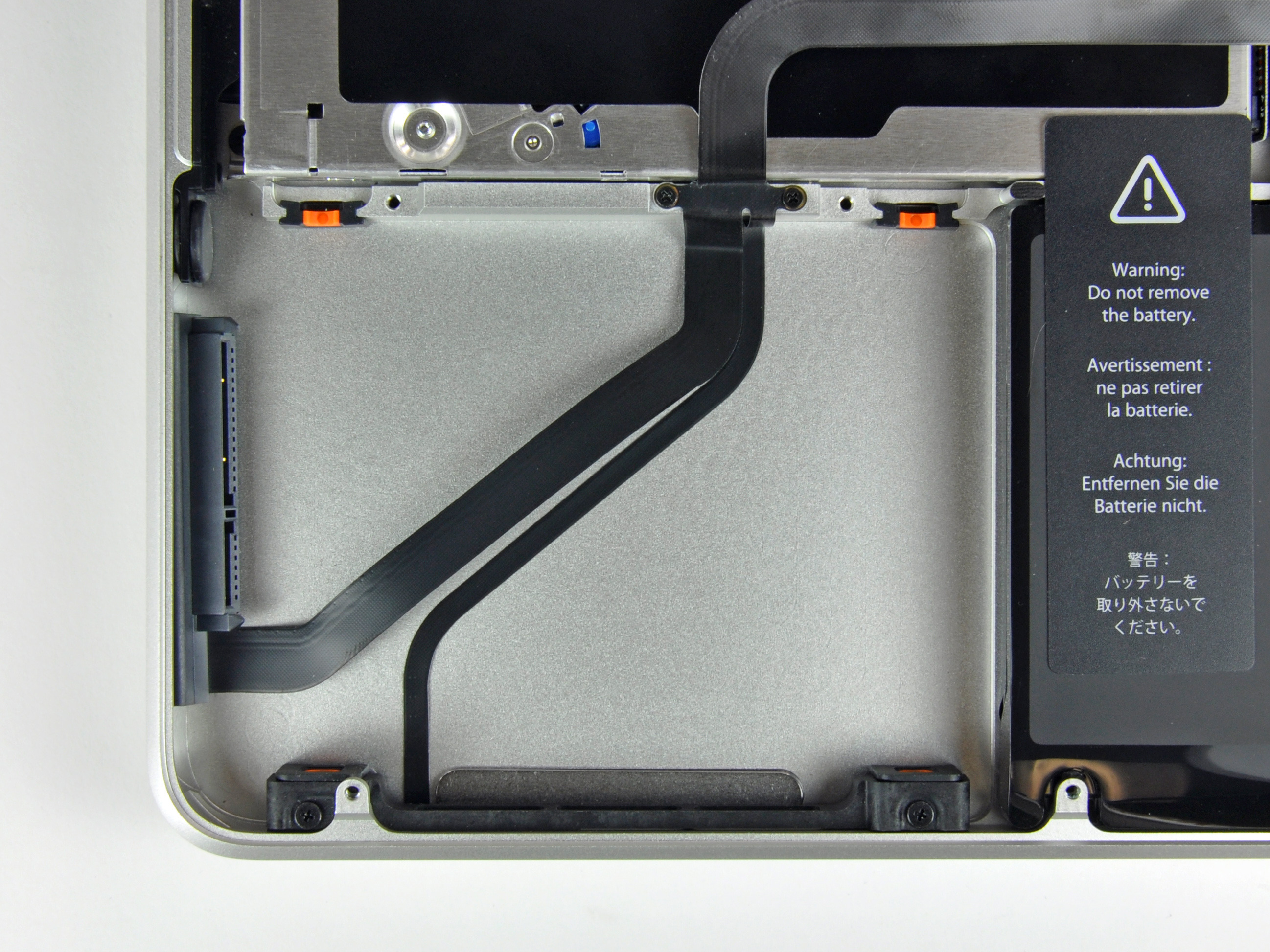

Remove the hard drive cable by pulling its connector straight away from the hard drive.
Remove the following four screws securing the hard drive and IR sensor cable to the upper case:
Two 1.5 mm Phillips screws.
Two 9.5 mm Phillips screws.
Slide the hard drive and IR sensor bracket away from the edge of the upper case.
Carefully peel the hard drive and IR sensor cable from the upper case.
Use the flat end of a spudger to pry the hard drive cable connector up off the logic board.

I bought the cable from ifixit and did have to peel off the IR receiver, which was surprisingly challenging. I'd never come across the ribbon cable clamp connection before and so didn't know how to open it, or how much of the new cable needed to go in. I'd also suggest marking the location of the cable that attaches to case bottom, before you pull it off. A few pencil marks would work. (That's probably a step 8 add)
gregsrow - Reply
I had the same challenge with the ribbon cable clamp. There is a tiny orange ribbon, visible in the lower left corner of the photo for step 10, above, that needs to be connected to the new part using a tiny clamp, also visible right there in step 10. To open it, you flip up part of the clamp that is opposite the ribbon. That will release the ribbon, and enable you to slide the ribbon into the new clamp, which then you can adhere to the bracket. Hope that's helpful for future fixers.
Bryony - Reply

Success. I agree that this is the trickiest part of the job, and is the least documented.
Getting orange ribbon cable off is relatively easy, but reseating it onto the new cable was an <OMG, I am going to break this> moment.
My approach was to slide the side of a credit card underneath and use that as an in situ support. I was then able to exert some lateral force to reseat the orange cable connector into the connector on the black plastic terminal piece of the new cable.
NB: I did unpeel the sticky back of the black piece before reconnecting cables.
Advice: at the end, stick the length of the cable to the case following the original path; make sure it is flush with the other side of the case on the short vertical drop. Any slack in the cable length will foul the replacement of the back IR sensor assembly.
Good Luck!
(PS: got my cable cheaply from eBay, but I note that the date stamped on the cable is 2009, so if it was a faulty batch from that period, maybe I have a problem in store for the future...?)
Leo - Reply
