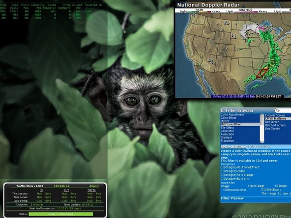

Where to go to locate image files responsible for Mission control and dashboard backgrounds. Then I will show you HOW TO SAFELY AND PROPERLY CHANGE THEM!

      • The Files within this folder are very important for part of your Mac's GUI; So Only mess with the following files mentioned!
      • "PIRELLI.png" & PIRELLI@2... These files are responsible for you dashboard background and Mission Control Tab for Dashboard(if enabled)
      • There is a set Tiling mode in the OS so selecting an image of proper size is crucial.
      • Create a new folder called "pirelliORIGINAL" and place these two AND ONLY TWO files here
      • Next Take your desired Image and rename it to "pirelli.png"
      • Dimensions: I Use 2880 x1900
      • And as shown move the image to the RESOURCES FOLDER

      • open up your terminal
      • type the following EXACTLY (case-sensitive) killall Dock [press enter]
      • *You may need to have super user permissions for the step above. If so, add the word "sudo" before the command above. (So the whole command will read sudo killall Dock)
      • 'YOU SHOULD NOW SEE YOUR NEW BACKDROPS!""
