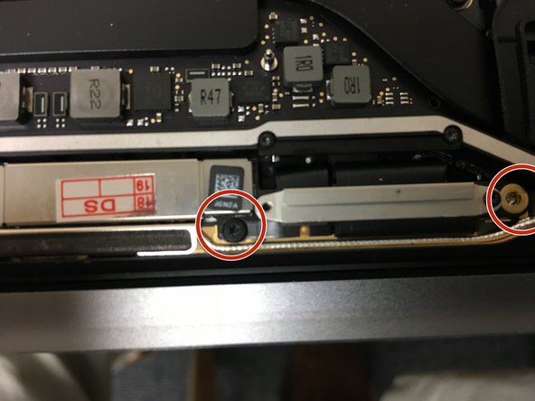

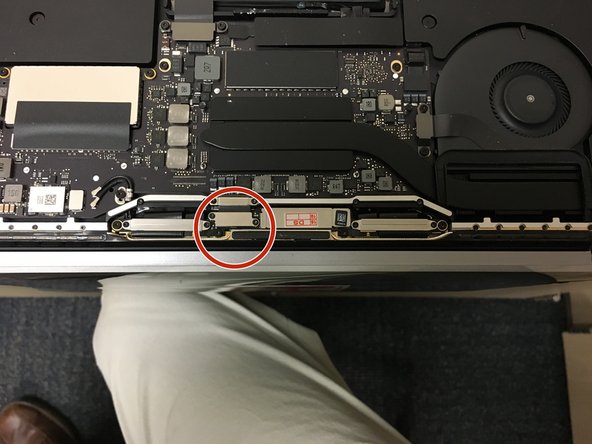

    8. MacBook Pro 13" Function Keys 2017 Screen Assembly Replacement: step 8, image 1 of 3 MacBook Pro 13" Function Keys 2017 Screen Assembly Replacement: step 8, image 2 of 3 MacBook Pro 13" Function Keys 2017 Screen Assembly Replacement: step 8, image 3 of 3
      • Remove the video cable cover. Use a plastic splugger to disconnect video cable.

    12. MacBook Pro 13" Function Keys 2017 Screen Assembly Replacement: step 12, image 1 of 2 MacBook Pro 13" Function Keys 2017 Screen Assembly Replacement: step 12, image 2 of 2
      • Time to wiggle all the cables out from under the vent bar we detached (the one with all the tiny screws).
      • Once this is done you can remove the screen assembly from the bottom kit.
