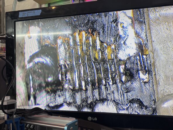

      • Tape the new cable, and begin to scrape off the solder mask
      • Use a hobby knife with a fresh blade, or a fiberglass pencil to expose a few mm of trace.
      • Using some light heat from a hot air gun can help with this step
      Ask FixBot

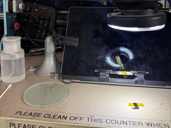

    1. MacBook Pro 13" Function Keys 2017 Display Backlight Cable (Flexgate) Fix, Cut the broken cable: step 34, image 1 of 1
      • Cut it just behind the break. Try and cut as straight as possible - this will allow the joint to be as clean and easy as possible.
      • Use a fresh razor blade, or utility blade to press straight down on the cable
      • I have attached a picture of my setup, as it can be tricky to work on. Find something to sit under the cable - I used a 5mm glass plate
      Ask FixBot
    2. MacBook Pro 13" Function Keys 2017 Display Backlight Cable (Flexgate) Fix, Scrape the solder mask off the display cable: step 35, image 1 of 1
      • Same as the new cable, tape the cable down, and scrape away a few mm of solder mask.
      • Be gentle - and use heat if needed. this coating can be tough. A fiberglass pencil is highly recommended

    3. MacBook Pro 13" Function Keys 2017 Display Backlight Cable (Flexgate) Fix, Align the new and old cables: step 36, image 1 of 1
      • Tape them down securely
      • Make sure that they are flat and clean
      • Green: Ground
      • Red: Power
      • Yellow: Signal (current return)

    4. MacBook Pro 13" Function Keys 2017 Display Backlight Cable (Flexgate) Fix, Bridge the ground connectors with solder: step 38, image 1 of 1
      • You don't need jumpers for the thicker traces, it is possible to gently flood them with solder, and bridge across
      • NOTE: Be quick with your iron, you don't want to melt the cable too bad - I set my iron to 450c and had the thinnest tip I could find in the lab.
      • The outermost traces are ground, the two thicker traces are backlight power and ground, and the thin traces are backlight return for current sensing
      • NOTE: it should work to bridge all the thinner cables together, but the backlight sensing will not work properly. I am not sure what the ramifications of this are but your backlight should still function.
