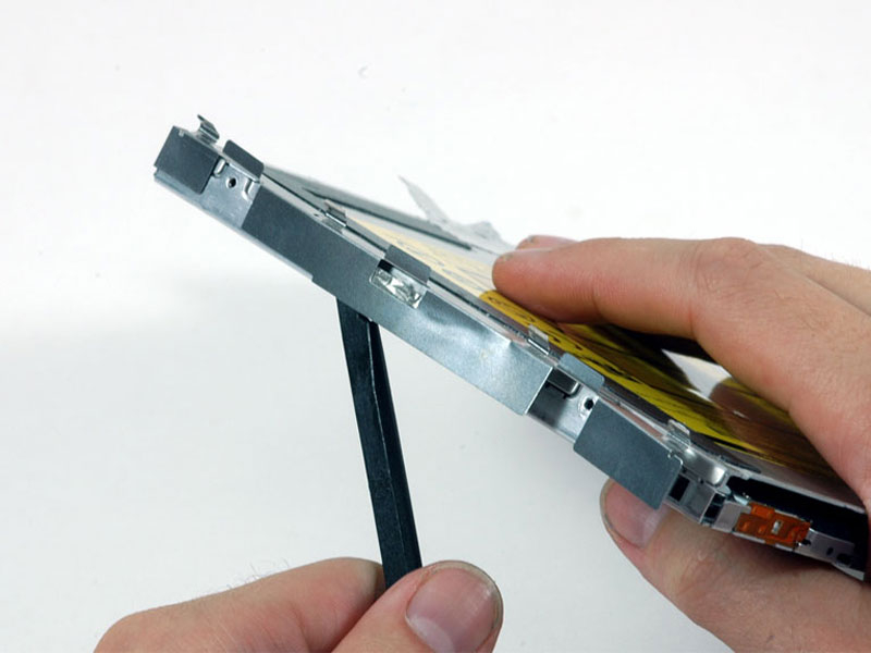

    1. MacBook Core Duo Optical Drive Replacement, Optical Drive: step 26, image 1 of 1
      • Use a spudger to carefully pry the silver metal bracket off the left side of the optical drive. Be careful not to bend the bracket, as it is very thin and bends easily. If the bracket doesn't come free easily, heating the adhesive may make prying the bracket off easier.
      Ask FixBot
