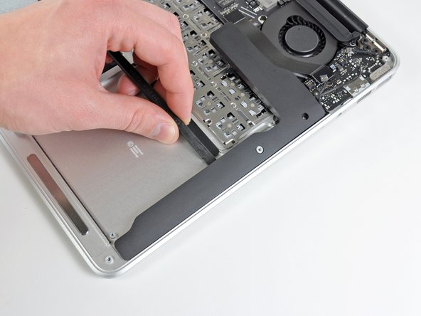

  9. MacBook Air 13" Late 2010 Left Speaker Replacement: step 9, image 1 of 3 MacBook Air 13" Late 2010 Left Speaker Replacement: step 9, image 2 of 3 MacBook Air 13" Late 2010 Left Speaker Replacement: step 9, image 3 of 3
    • Use the flat end of a spudger to pry the left speaker off the adhesive securing it to the upper case.
    • Remove the left speaker from the upper case.
