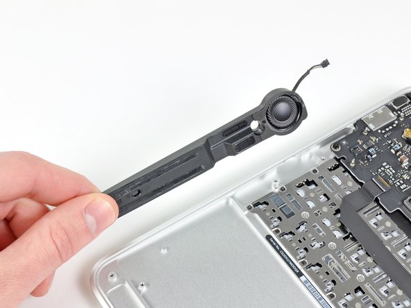

  8. MacBook Air 11" Late 2010 Right Speaker Replacement: step 8, image 1 of 2 MacBook Air 11" Late 2010 Right Speaker Replacement: step 8, image 2 of 2
    • Use the flat end of a spudger to pry the right speaker off the adhesive securing it to the upper case.
    • Only pry up on the speaker from the areas of bare aluminum on the upper case. Prying up from the keyboard area may damage the keyboard and the speaker itself.
    • Remove the right speaker from the upper case.
