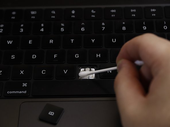

  2. MacBook Air & MacBook Pro (Newer than 2019) Sticky Key Fix: step 2, image 1 of 3 MacBook Air & MacBook Pro (Newer than 2019) Sticky Key Fix: step 2, image 2 of 3 MacBook Air & MacBook Pro (Newer than 2019) Sticky Key Fix: step 2, image 3 of 3
    • Dip a cotton swab into high-concentration isopropyl alcohol and clean the surface/surroundings of the keycap.

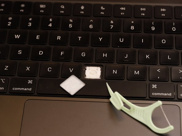

  3. MacBook Air & MacBook Pro (Newer than 2019) Sticky Key Fix: step 3, image 1 of 2 MacBook Air & MacBook Pro (Newer than 2019) Sticky Key Fix: step 3, image 2 of 2

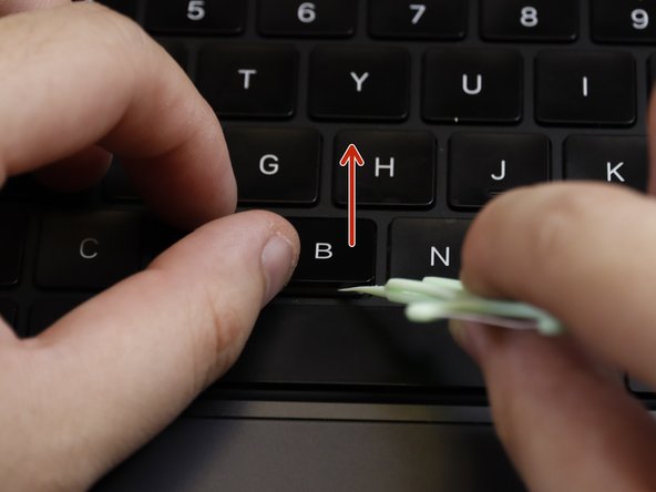

    • Use a toothpick to gently remove crumbs or debris stuck in the gap between the keyboard metal and keycaps.

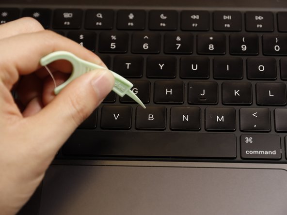

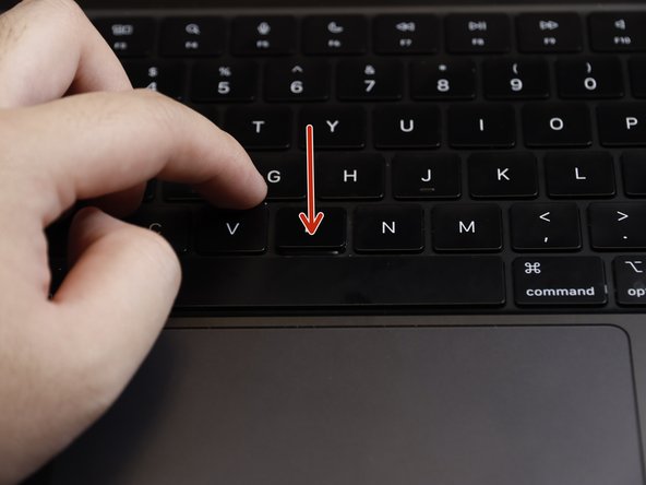

  4. MacBook Air & MacBook Pro (Newer than 2019) Sticky Key Fix: step 4, image 1 of 3 MacBook Air & MacBook Pro (Newer than 2019) Sticky Key Fix: step 4, image 2 of 3 MacBook Air & MacBook Pro (Newer than 2019) Sticky Key Fix: step 4, image 3 of 3

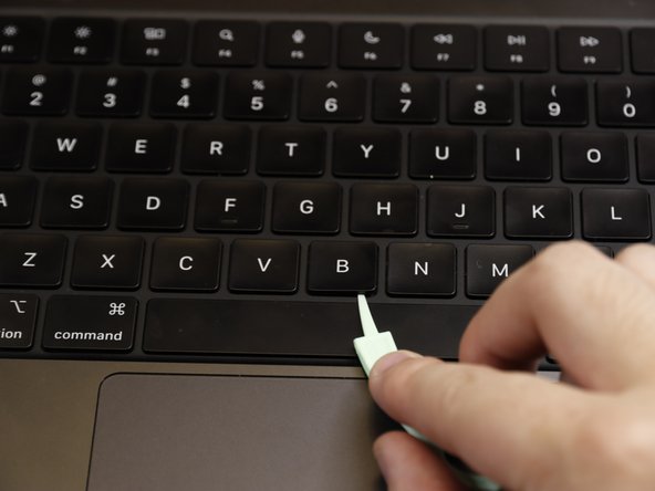

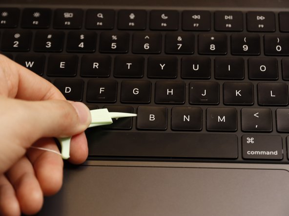

    • Gently use the toothpick to pry up sticky key(s) from the bottom of the keycaps.

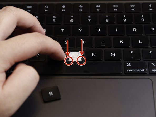

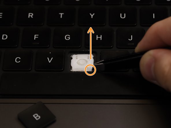

  5. MacBook Air & MacBook Pro (Newer than 2019) Sticky Key Fix: step 5, image 1 of 3 MacBook Air & MacBook Pro (Newer than 2019) Sticky Key Fix: step 5, image 2 of 3 MacBook Air & MacBook Pro (Newer than 2019) Sticky Key Fix: step 5, image 3 of 3

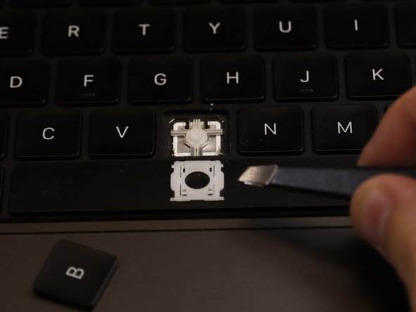

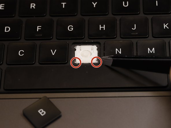

    • Remove the 2 plastic key carrier parts using tweezers.
    • Use tweezers to grab one side of the tip (circled in orange) of the carrier parts and pull it out. Do the same thing on the other side of the tip.

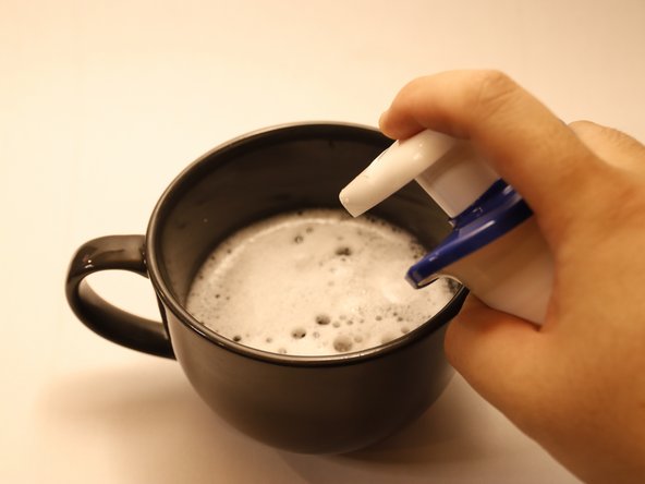

  6. MacBook Air & MacBook Pro (Newer than 2019) Sticky Key Fix: step 6, image 1 of 1
    • Use cotton swabs with damp with high-concentration isopropyl alcohol to clean the part underneath the key carriers.

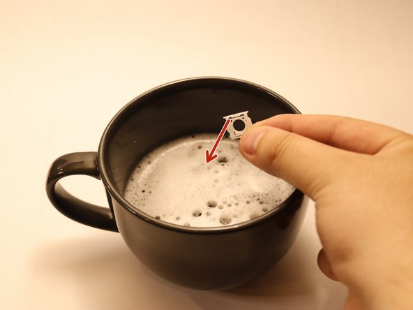

  7. MacBook Air & MacBook Pro (Newer than 2019) Sticky Key Fix: step 7, image 1 of 3 MacBook Air & MacBook Pro (Newer than 2019) Sticky Key Fix: step 7, image 2 of 3 MacBook Air & MacBook Pro (Newer than 2019) Sticky Key Fix: step 7, image 3 of 3

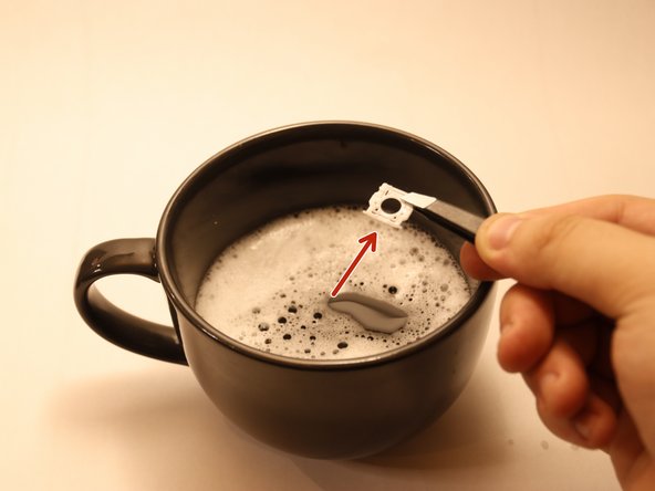

    • Put dish soap and warm water in a cup and soak the 2 key carriers in the cup for 10 min.
    • Stirring may help.

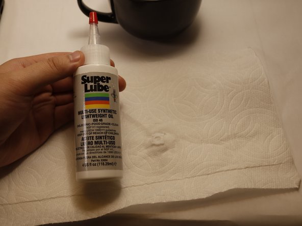

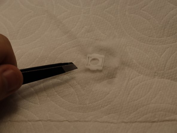

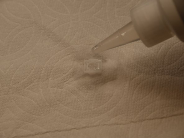

  8. MacBook Air & MacBook Pro (Newer than 2019) Sticky Key Fix: step 8, image 1 of 3 MacBook Air & MacBook Pro (Newer than 2019) Sticky Key Fix: step 8, image 2 of 3 MacBook Air & MacBook Pro (Newer than 2019) Sticky Key Fix: step 8, image 3 of 3
    • Let the carrier parts dry on a tissue paper.
    • Use The Super Lube LightWeight Synthetic Oil to lube the 2 carriers before assembling them, especially the parts that contact with other parts.
