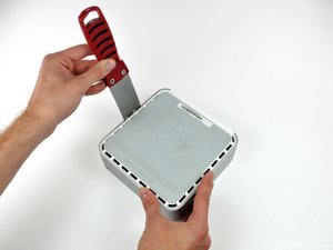

      • Power down your Mac mini, disconnect all of the cables, and flip it over.
      • Insert the Jimmy into the crack between the aluminum top housing and the plastic lower housing.
      • The Jimmy should reach a stop about 3/8" down.

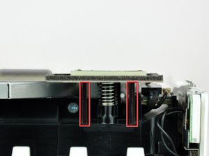

      • You may need to move the Jimmy along the edge to pry up all of the clips. Be patient and do a little bit at a time.

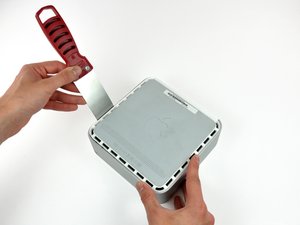

      • Keep working around the perimeter, freeing the clips along the final edge.

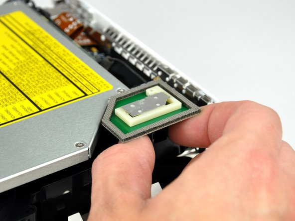

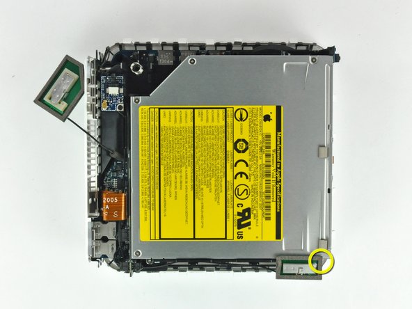

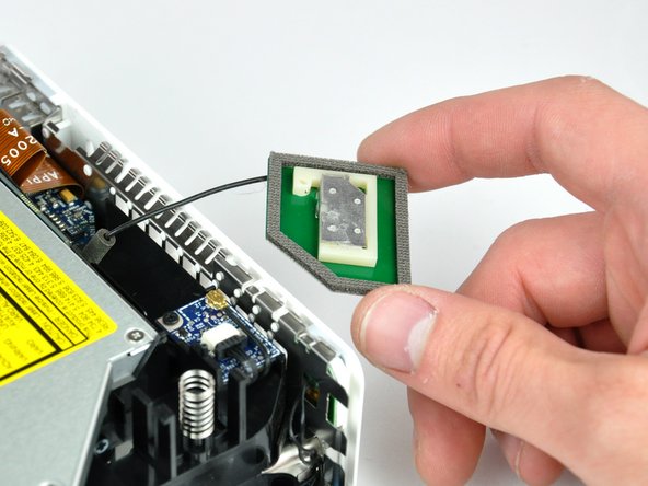

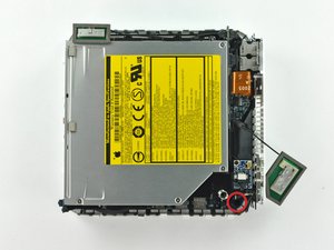

    1. Mac mini Model A1176 PRAM Battery Replacement, Internal Frame: step 7, image 1 of 3 Mac mini Model A1176 PRAM Battery Replacement, Internal Frame: step 7, image 2 of 3 Mac mini Model A1176 PRAM Battery Replacement, Internal Frame: step 7, image 3 of 3
      • Later in this guide you will remove several recessed Phillips screws. Bit drivers are generally too large to fit in the recesses, so be sure to have a thin shafted Phillips screwdriver on hand.
      • First remove the AirPort antenna (the larger of the two), located near the power button.
      • Slightly squeeze the two retaining arms toward each other and lift the AirPort antenna off its post.
      • Squeezing the two posts excessively will surely break them off the internal frame. Work delicately.
      • During reinstallation, you will have to slightly squeeze the two posts together so they fit into the openings on the AirPort antenna board.
      Ask FixBot

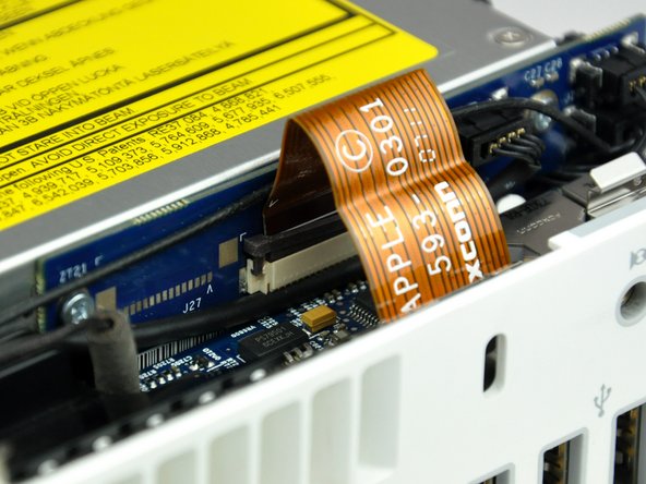

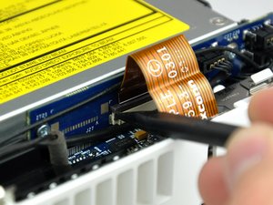

    2. Mac mini Model A1176 PRAM Battery Replacement: step 8, image 1 of 2 Mac mini Model A1176 PRAM Battery Replacement: step 8, image 2 of 2
      • Use the tip of a spudger to slightly lift the left side of the ZIF cable lock up from its socket.
      • The ZIF cable lock will lift about 1 mm and stop. Do not try to completely remove the ZIF cable lock.
      Ask FixBot
    3. Mac mini Model A1176 PRAM Battery Replacement: step 9, image 1 of 1
      • Lift the audio board ribbon cable up out of its socket.
      • If it refuses to lift from its socket, the ZIF cable lock is not fully released. Make sure it is evenly lifted about 1 mm from the socket on the interconnect board.
      Ask FixBot

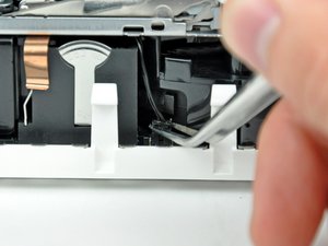

    4. Mac mini Model A1176 PRAM Battery Replacement: step 10, image 1 of 2 Mac mini Model A1176 PRAM Battery Replacement: step 10, image 2 of 2
      Tool used on this step:
      Buy

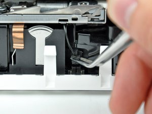

      • Rotate the mini so that the SuperDrive slot loading mechanism is facing you.
      • Use a pair of tweezers to lift the hard drive thermal sensor cable connector up off its socket on the logic board.
      • Use tweezers to grab the connector (as seen in the picture), not the wires.
      • The connector is located under the optical drive opening, next to the PRAM battery.

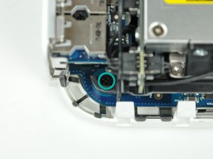

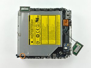

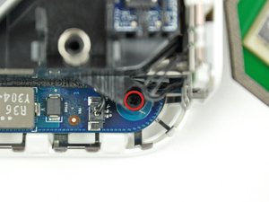

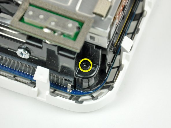

      • In the next few steps, you will remove the four Phillips screws securing the internal frame to the bottom case. Included in each step is an overview picture showing the general location and a closeup showing the actual screw.
      • Remove the recessed Phillips screw near the power button securing the internal frame to the bottom housing.
      Ask FixBot

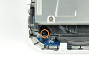

    6. Mac mini Model A1176 PRAM Battery Replacement: step 12, image 1 of 2 Mac mini Model A1176 PRAM Battery Replacement: step 12, image 2 of 2
      • Remove the recessed Phillips screw near the sleep light securing the internal frame to the bottom housing.
      • This screw is the longest of the four screws securing the internal frame to the bottom case.
      Ask FixBot

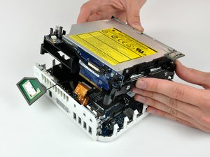

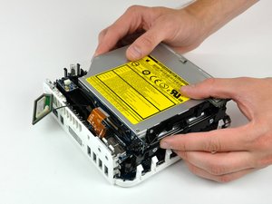

    9. Mac mini Model A1176 PRAM Battery Replacement: step 15, image 1 of 2 Mac mini Model A1176 PRAM Battery Replacement: step 15, image 2 of 2
      • Gently lift the internal frame up from the bottom housing, minding the AirPort antenna and any other cables that may get caught.
      • It may be necessary to pull up near the interconnect board to separate it from the logic board.

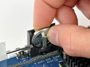

    1. Mac mini Model A1176 PRAM Battery Replacement, PRAM Battery: step 16, image 1 of 2 Mac mini Model A1176 PRAM Battery Replacement, PRAM Battery: step 16, image 2 of 2
      • Push the PRAM battery toward the center of the logic board and pull it up out of its holder. You'll have to push the battery in further than you'd expect in order to get it to pop free.
      • Don't bend the metal finger too much or it will break off, requiring a new logic board.
      • When inserting the new battery, make sure the side with writing along the edges faces the black plastic holder. You should also insure that the metal connectors make contact with the battery (you can bend them forward if they do not).
