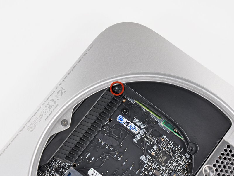

    1. Mac mini Mid 2011 Cowling Replacement, Cowling: step 6, image 1 of 1
      • Remove the single 3.5 mm T6 Torx screw securing the cowling to the heat sink.
      Ask FixBot
    2. Mac mini Mid 2011 Cowling Replacement: step 7, image 1 of 1
      • Lift the cowling from the end nearest the antenna plate.
      • Rotate the cowling away from the outer case and remove it from the mini.
      Ask FixBot
